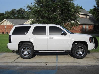

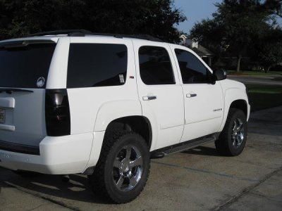

Finally got everything installed and ended up going with CCM leveling kit and 305/55R20 BF Goodrich Tires.

Dave looks good. I wonder why you had less triming (a lot) compared to InTruck? I wonder what the offset difference is.
Mr. B the CCM kit raises the rear as well. On mine the rear was ~0.25" higher, barely noticable.

Zed, I had trimmed some when I had my old tires on the truck so that is probably the reason but i will say that th offset on the rims is perfect for this setup. Both the front and the rear are sitting at 40 inches.
