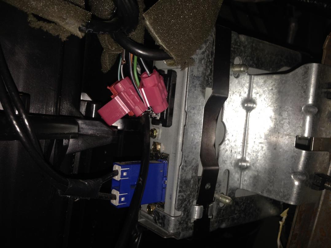

2: Drop your glove box by opening the glove box and pushing the one tab inwards on the right side on the glove box.
3: In the upper right side you will see a medal box with one connector that is your XM radio receiver.(see Pictures)
4: The AUX cord will have three wires and that's all you need for this job. the wires you will be connecting are as follows:
From the XM receiver BLACK WITH WHITE STRIPE (to the smaller wire on the AUX CORD which is the signal wire)
From the XM receiver GREEN WITH WHITE STRIPE ( to one of the two wires left on the AUX cord does not matter which one)
From the XM receiver BROWN WITH WHITE STRIPE (to the last and final wire on the AUX cord)
(see pictures)

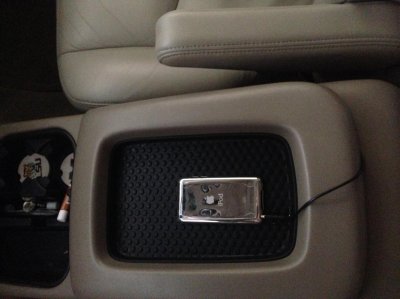

5: Hide your cord wherever you want, I ran my down the center console and into the storage area. (see Pictures)

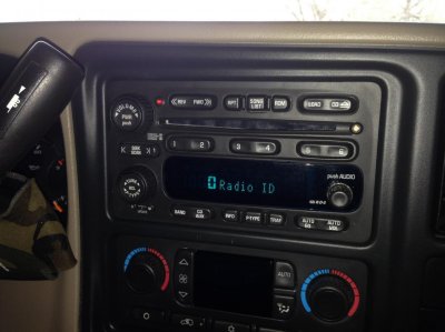

6: This is the last step to test it out turn to your XM radio setting and go to the radio ID station (this cuts out all the static) and you should be all set to play your ipod.
