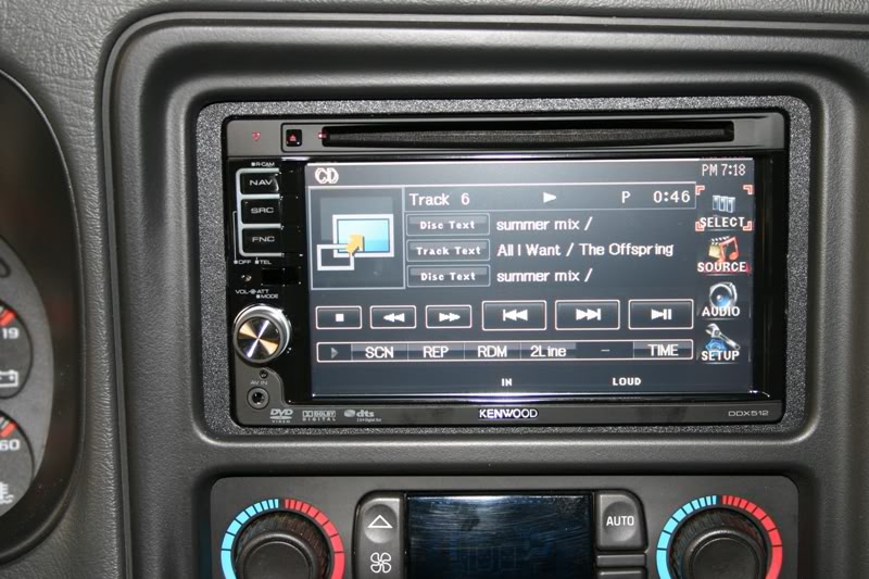

Here's just an example of an aftermarket double din radio, just so you have an idea how close to factory it will look:
If you are dead set on keeping your factory radio, you can add most of the things you mentioned. However, it will cost more, be significantly harder to install, will probably look less factory, and will not function as well as just replacing the radio.
