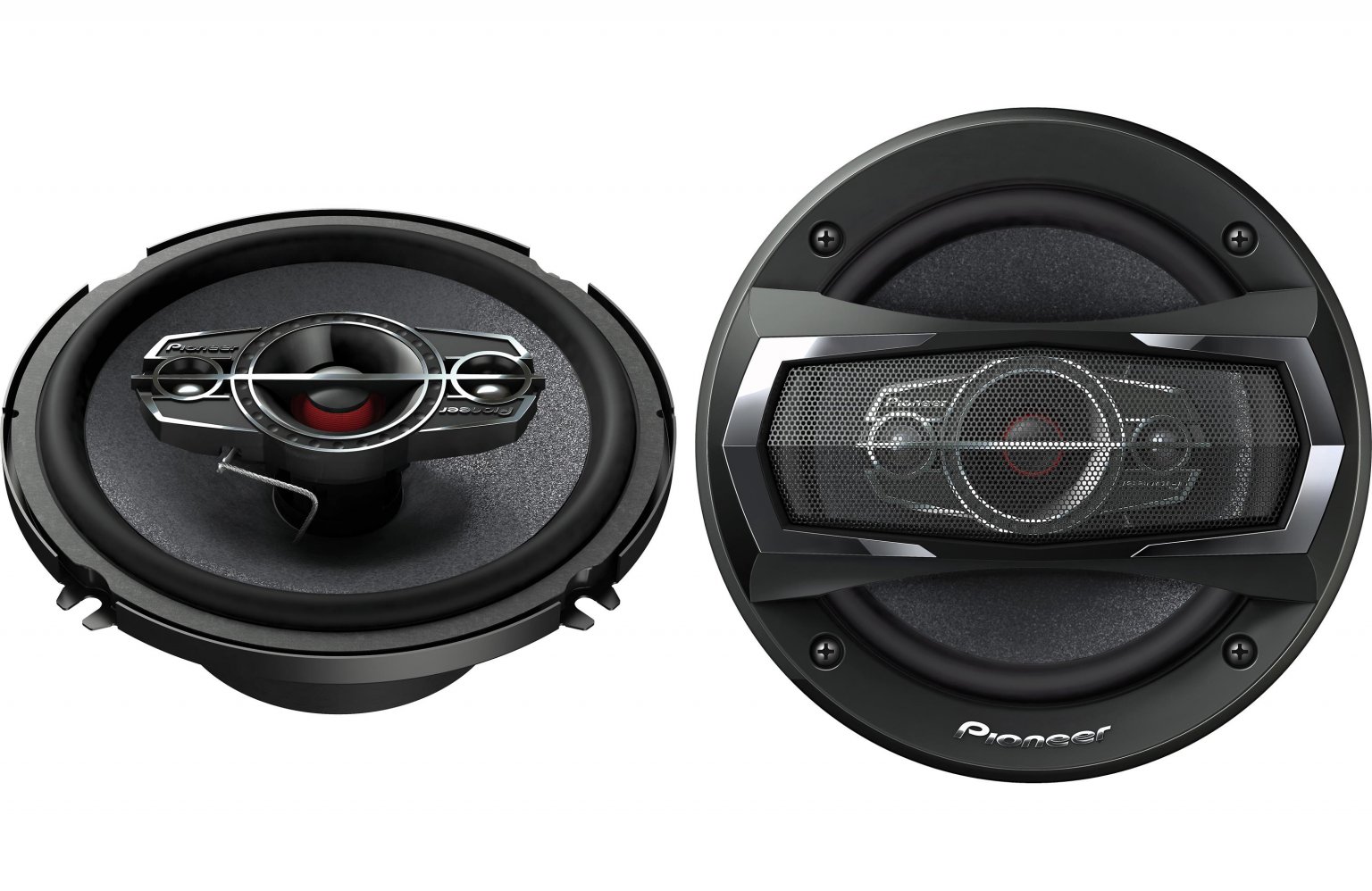

First off I replaced the speakers first about 2 months ago with Pioneer Ts-Al676R speakers.
http://www.crutchfield.com/S-iuvNQrElC1F/p_130TSA1685/Pioneer-TS-A1685R.html
World of a difference and it sounded great, However I knew about the harness and I knew the back sub was trashed still. So it was replaced a few weeks later with a 8" Shallow Pioneer Ts-sw2002D2
