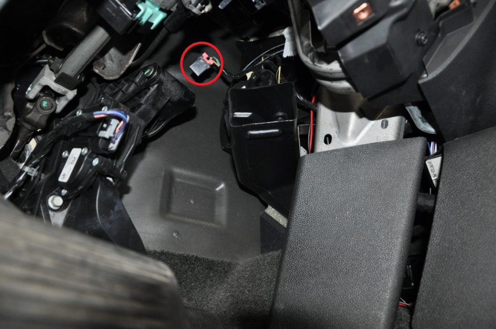

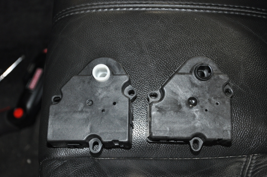

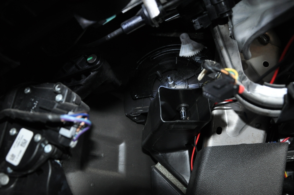

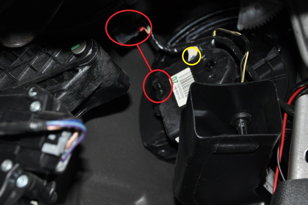

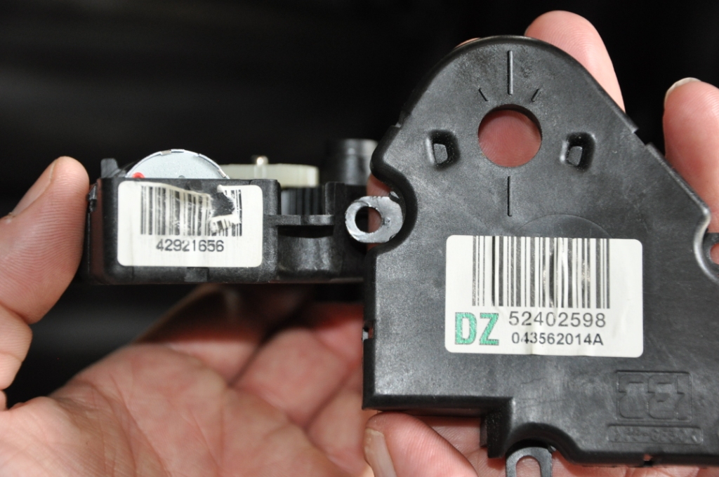

Well, I think this is the cluprit...
I'm going to tackle it myself just need to determine where to get it from seems like there is a modest difference in prices. Not sure if there is a quality difference.

How did you track it down to that part number? I wonder if it is the same part number for the Tahoe. Mine is out of warranty so a DIY fix sounds good.

goodinblack said:
That diagram show a Expedition.
Apparently they changed the links to the pictures cause they were right.
As for the part numbers, I have a subscription to alldatadiy and pulled the information from there. It had all the pics and technical details.
