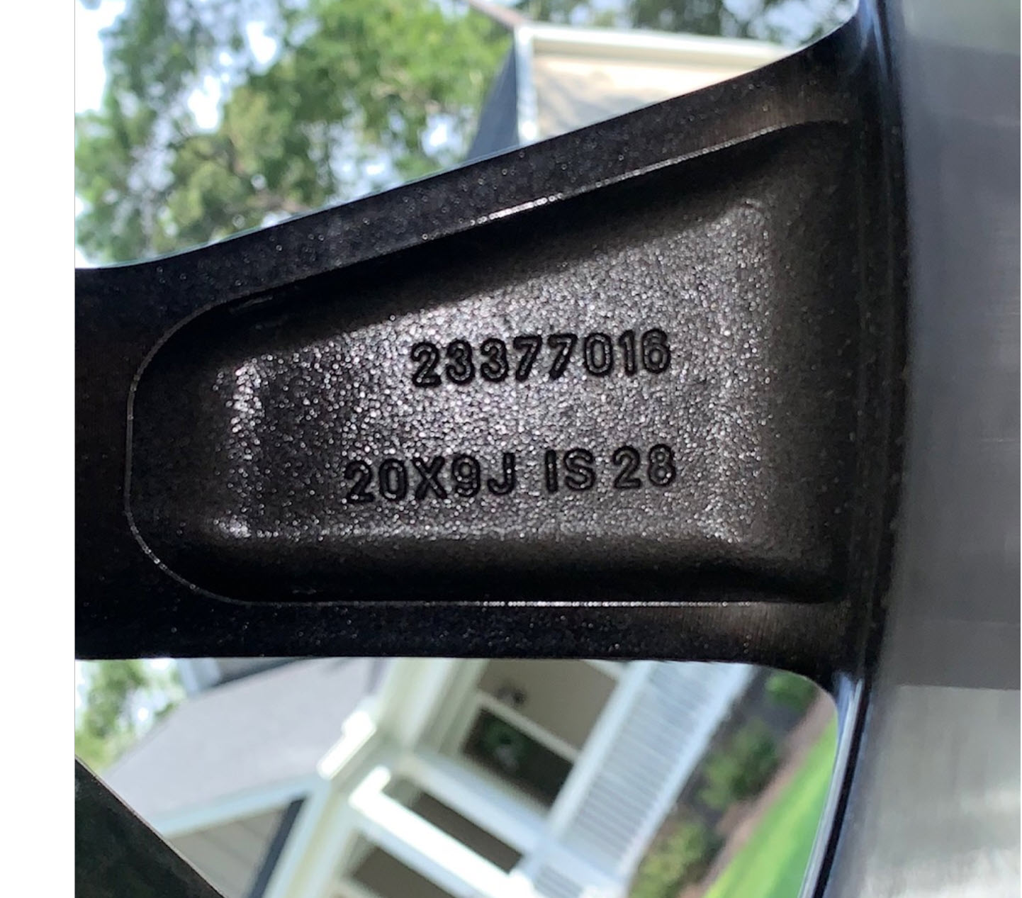

Depends on the year. I don’t know where the change occurred but 2013 was 31mm and 2018 was 24mm.
Edit: Sorry, this is offset. You would need to calculate the backspace by subtracting the offset from the wheel width.

^ they dont refer to backspacing on the newer vehicles.... they go by offset now
(related but diff)
& i dont recall seeing offset for the T1xx platform yet.
3 of the sites that i would look for that info , dont even have the 2021's listed yet

I just installed some 2019 Sierra Denali replica wheels in the 20x9 size. They have a 24mm offset. Fit perfectly
