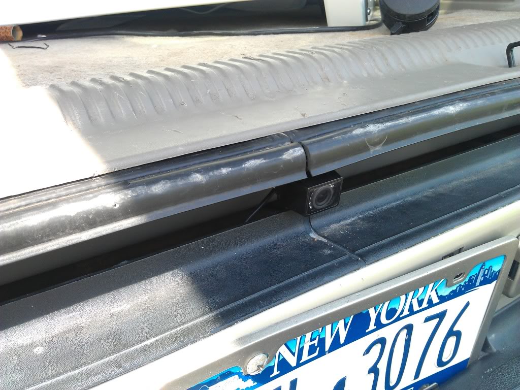

If you aren't worried about getting your hitch in i found the best place for mine was under the bottom of the rear gate. Got the idea from 05nali.

^^^damn missing license plate screw... :whymewhyme: I have had no problems with this location. Perfect for everyday use and backing into my trailer

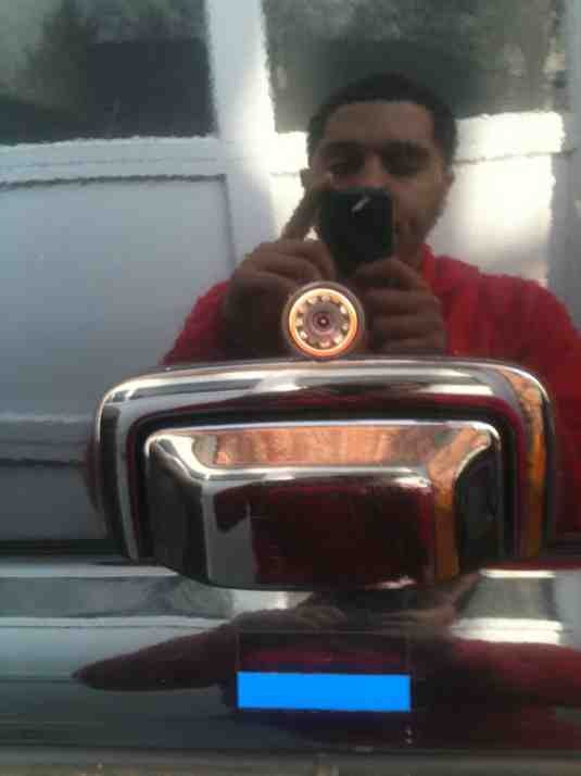

I have the keyhole style cam.
See the squarish hole right above the receiver? (random google pic) I cut a metal plate and covered that and put my cam in it so it's flush mounted. Works perfect for me.

no pic, but I'll see if I can get one for you. I've never seen what other cams look like but I could see the very tip of ball on my hitch so it was awesome hooking up my boat.
Really easy. cut plate to fit hole. drill hole in the plate for cam. run wires through hole and tighten cam to plate. Then weld it on. Just make sure you take your time welding so it doesn't get too hot.
I was scared at first because If I ever needed to do something to the cam I'd be grinding the plate off, but in 2 years it's been fine.
