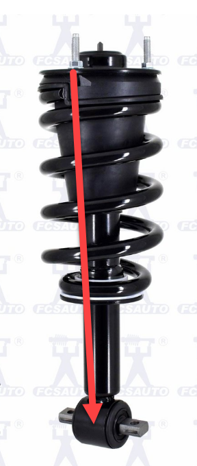

I decided to replace both from struts on my 2016 Yukon. This is the third time I've replaced these combination spring/shock assemblies on Yukons or Tahoes, but I ran into a problem that hopefully will prevent you from having the same problem I had.
I bought a pair of after-market (OEM replacement 'QuickStruts) from NAPA - because I couldn't find the combination units available online from Delco or GM. The first one installed with no problem. However, the second unit had a manufacturing defect that I didn't discover until I tried to install it.
Here's what I learned (the hard way): One of the top mounting studs MUST perfectly align with the center of the lower shock mounts. The attached picture doesn't show it exactly because of the perspective of the photo - but if those two points points don't light up closely (+/- a couple of degrees), the installation will be all but impossible. So when you buy your new strut assemblies - open each box of each and check the alignment.
When I called my local NAPA store, fortunately, they had two of the same assemblies in stock - and they sent a driver to my house on Saturday with both units - one of which was fine - and swapped it for the defective unit.
I hope this saves someone a significant hassle.
