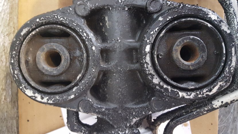

08grey
Jun 17, 2012
4,596
725
This is the main support for the rack. They wear out super fast.
