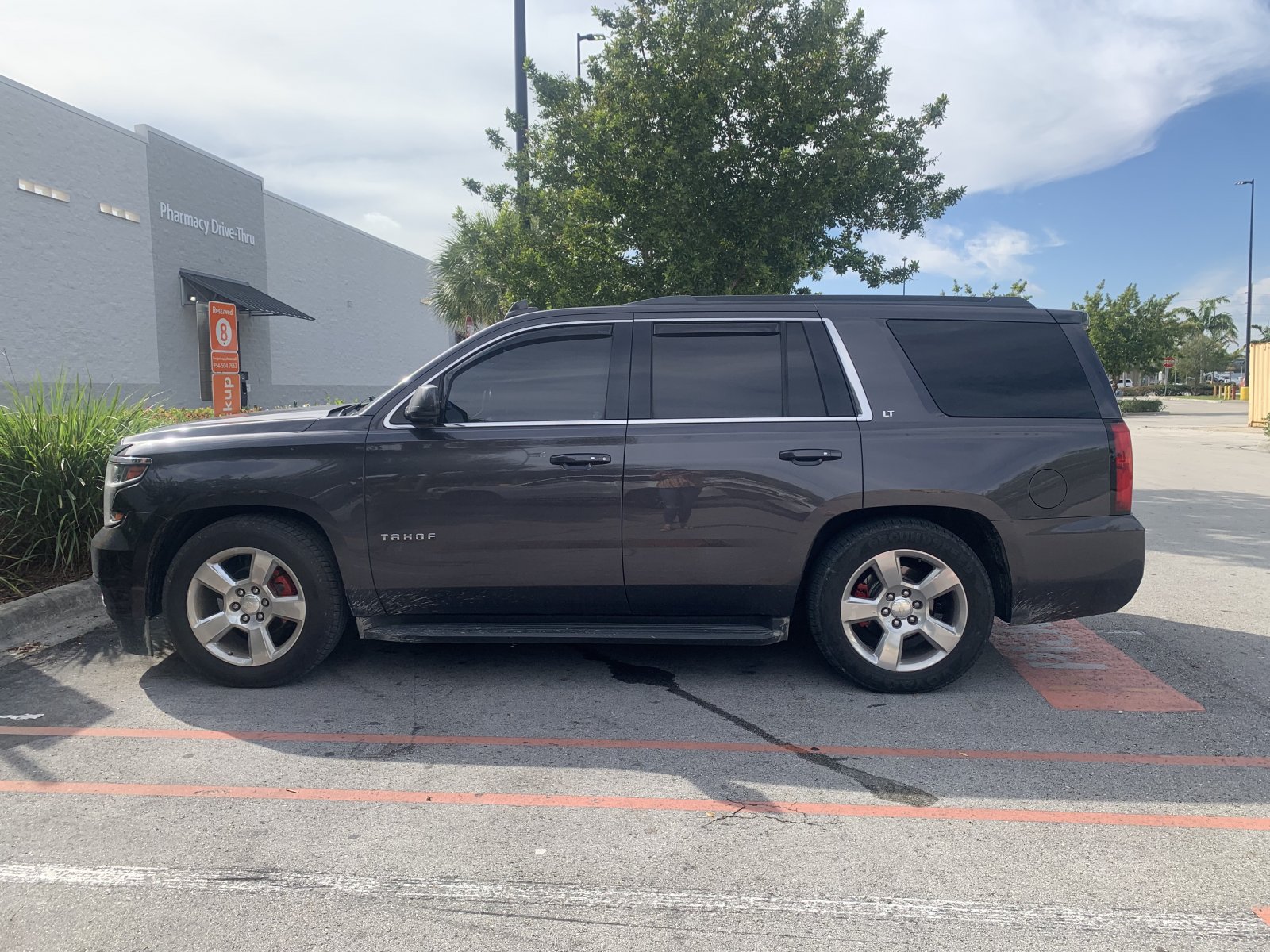

Hey all. I did some searching and reading but I’m not seeing what I’m dealing with. So, sorry if this is a repeat.
2016 Tahoe LT 90k miles
Finally got around to lowering, my bf got it for me for Christmas.
Did a Free travel mod, used belltech 1019 lowering kit (2/4), djm sway bar links. Also shorter bump stops.
The rear looks high. There’s a 2 inch difference between the front and rear. What could it be? It’s not looking how I wanted at all. The rear looks the same height as when it started?
Wanted a more low and level look. I’m seeing people with their trucks looking much better.
Tire isn’t straight and a bit dirty but you’ll see what I’m talking about.
This is what it looked like before, a better picture.
Is there a fix? Did we miss something??

Is it mag ride? I’m assuming so since you used the 1019 kit. Did you adjust the mag ride rods?
Wolfpack79
Oct 29, 2020
21
20
Yes, he says he did. To 3 inches. That’s what the instructions say. Should they be shorter?
Most of what I’ve read the rods should be closer to 2.75” not sure that’ll get you dropped enough though. Maybe some others will chime in. I have the same kit but I haven’t put it on yet so I don’t want to misspeak

I don’t understand why it’s not lower
D
dani_yellz
Dec 22, 2020
24
29
It doesn’t make sense. It looks like the back didn’t drop at all
That’s what we are confused about. Our neighbor said it looks like it didn’t drop at all.
I think we have just looked at it a lot, and we didn’t measure the distance before, because why would we do that? Lol. …but really, he is mechanically inclined.

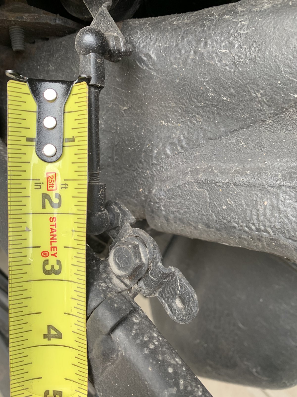

My ‘15 Yukon XL is not even a full 3” drop in the rear and my rods are about 1-1/2” in length. This is when measuring the length of exposed rod between the sensor connections.
Here’s a pic of my rear auto ride sensor rods:
Since you are going for closer to 4” rear drop you may end up with rods that are closer to 1” in length or shorter?
It doesn’t take much adjustment in rod length to change the ride height. A general rule of thumb is for every 1/8" change in sensor rod length it changes the ride height by 3/4".
Hope this helps.

3” Is going to be way too long for how much you want to drop the rear.
Did the kit come with new rear auto ride sensor rods? If it did not you can make some out of 3” long 10-24 machine screws. Just cut the head off the screws and I would recommend using stainless steel ones.
Regardless of the lowering kit you used you will need shorter rear auto ride sensor rods to achieve anything closer to a 4” rear drop.
Post #4 of this thread here has more details on the kit I used and how my Yukon XL Denali sits:
Hope this helps.
