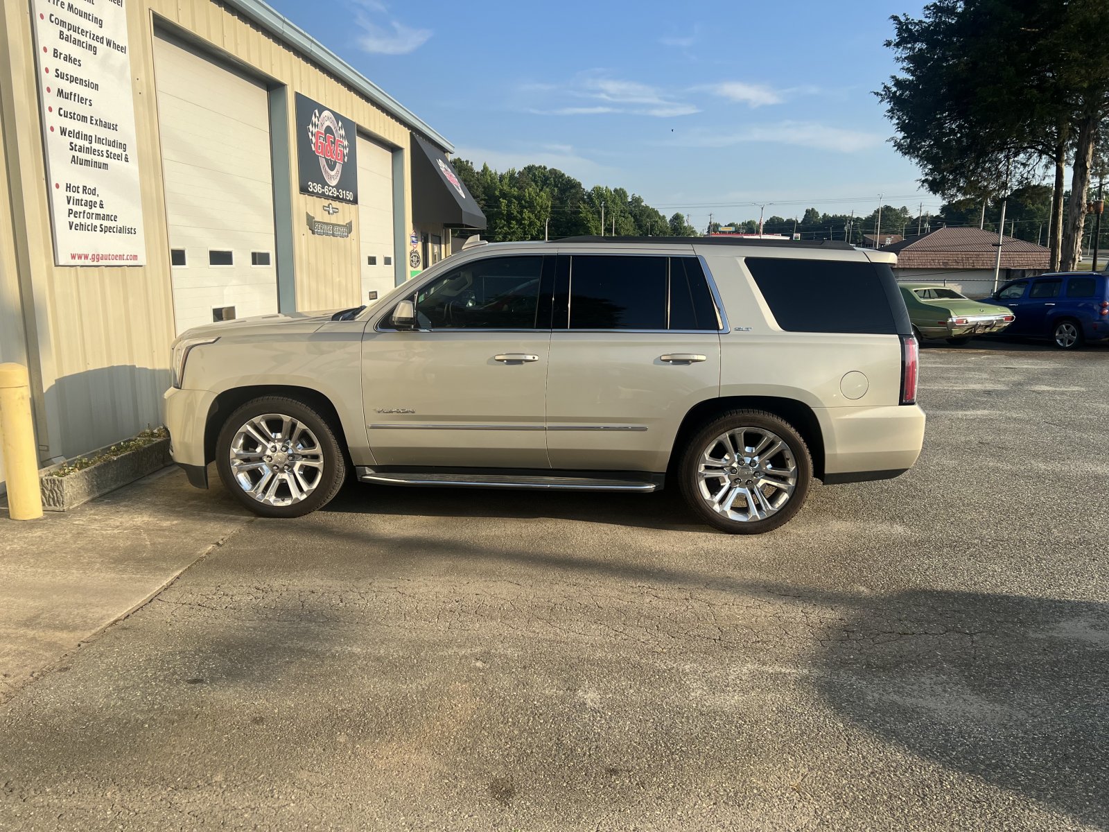

Can you get measurements from the ground to the fenders of the front and the back? I just did my wife's and I only got 1" in the front and around 2 1/4" in the rear. My sensor rods are 2 3/4 center to center. I would like another 1/2" in the front with another 1 1/2 in the rear would make me happy.

Looks great. Those ride height sensor rods will get ya every time. They think you just put a huge load on the rear and then tell the compressor to air up the shocks to the normal stock height.
