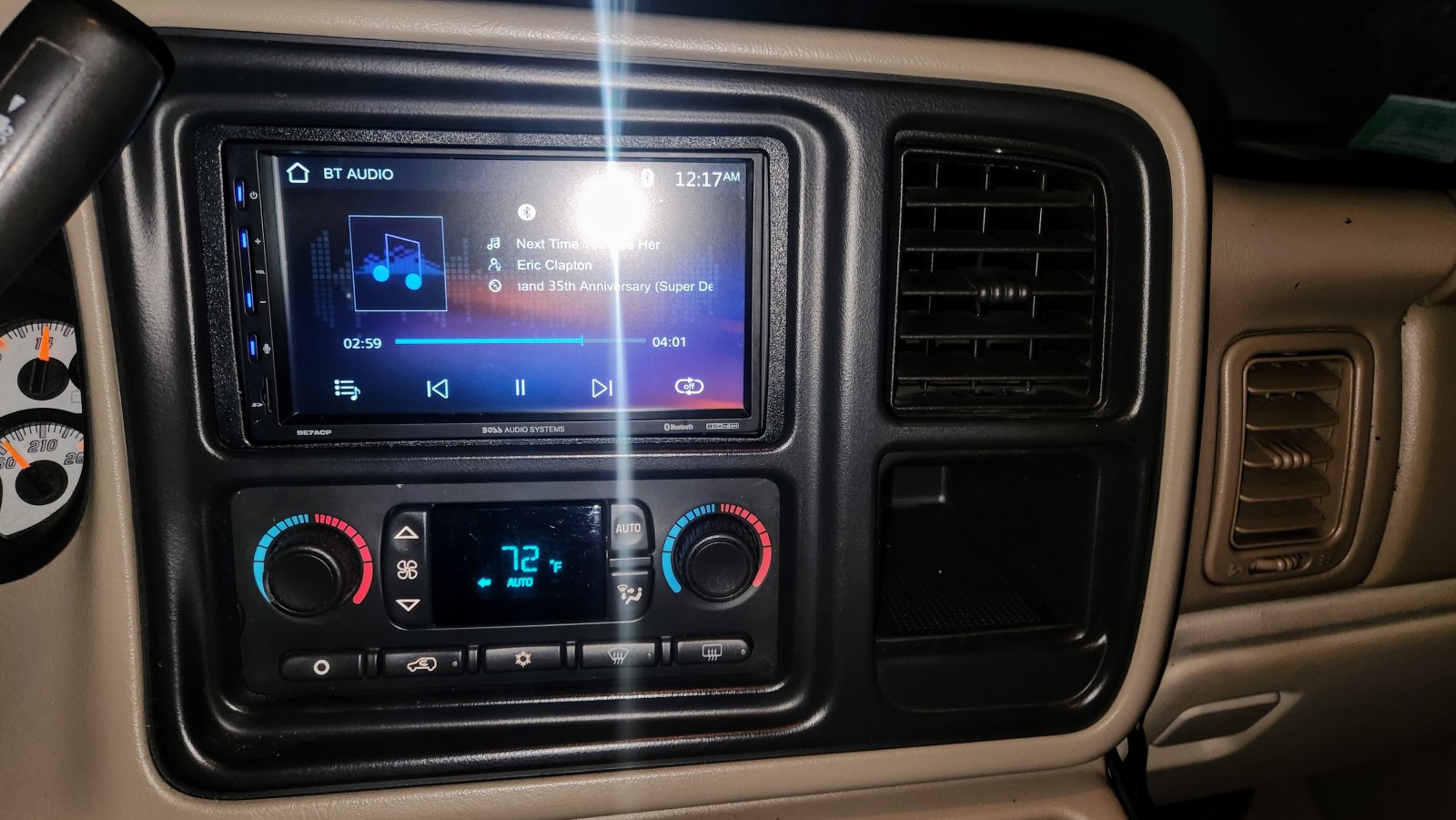

New radio head unit made HUGE improvement using my factory Bose amplifier and speaker system!
Boss BE7ACP and everything needed for plug and play install was about $380 all-in and shipped from Crutchfield and I am really impressed!
If you have the factory NAV radio, this Boss head unit will fit with plenty of room behind it. No dash cutting involved.
It really sounds great on the Bose speakers and the subwoofer is making enough thump for my taste. Great overall sound balance and clarity, which is the Bose trademark...
Our trucks already have a reverse trigger in the harness. Since I had Crutchfield do all the connections on the new harness connectors needed for install as part of their Ready Harness service, I did not have to do a thing. The radio already connects to the reverse trigger on the harness. No need to pull the dash apart to find the trigger.
When I ad my cam later this week, the only things needed are: 1) Run the Yellow tipped video feed wire up to the rear cam RCA connector on the back of the radio; and 2) Use a quick tap connector to tap 12V+ from the revers light wire in the tail lamp or underneath at the trailer tow harness to supply power. Done!
This was such an easy, affordable and quick upgrade that will make life on the road so much better!
Photo is a re-post from "What I did to my Tahoe today" thread...
