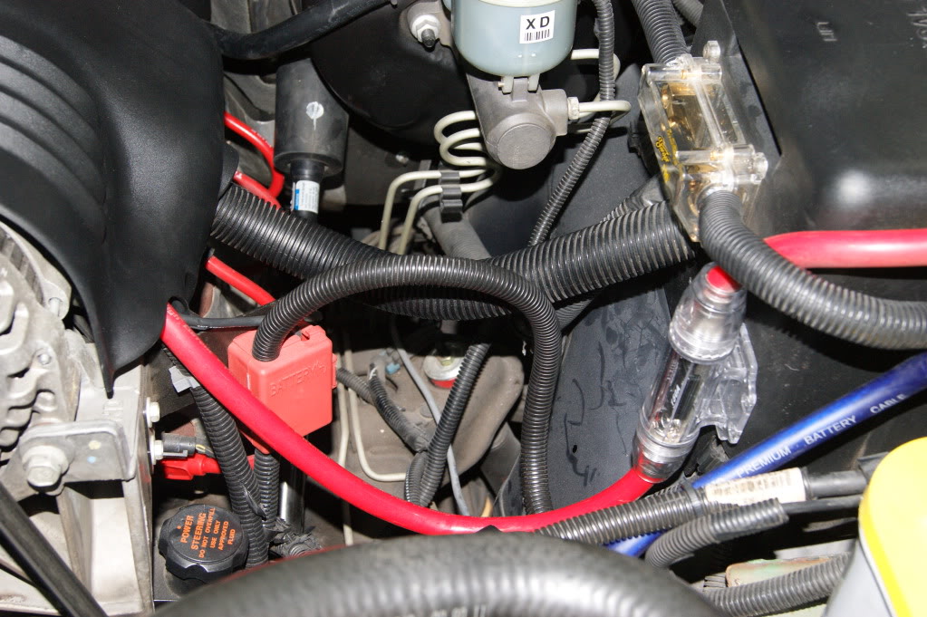

ok guys do i NEED to run a fuse between the wire from my batt. to alt. or can i run a straight wire?
carcrz
Dec 21, 2009
875
80
Georgia
run a fuse bro to be safe, the vertical fuse you see is the one running from the alt. to the batt.

thanks carcrz been in the auto industry for 20 years and never done a big 3 i stick with autobody also what size fuse should i use?
