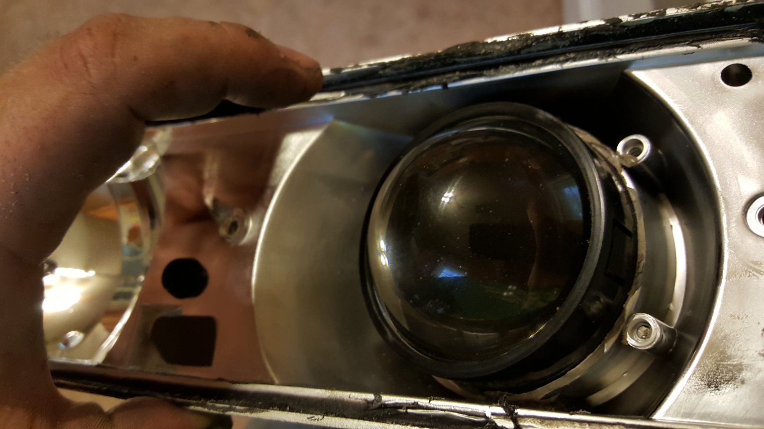

Removing all the fittings, screws, etc, to open the lenses, i set my oven at 270*, popped them in for 10 minutes, and then carefully pried them open with a butter knife. 20150916_153053.jpg
the inner black shield comes out easily enough, if you plan to use them I'd use this opportunity to swap the LEDS to better ones as they tend to burn out fairly quickly. I don't plan to use them so i left them alone.
removing the shield and reflector on the back leaves a bare lens and retainer as shown here. 20150902_143901.jpg 20150822_225436.jpg

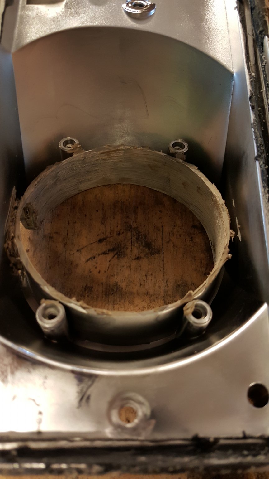

removing the screws on the metal ring allows the removal of the lens as well WOO bare housing!
the next step involves our good friend Mr Dremel! first we cut off the top of the old lens retainer
and bore out the inside a bit to accept the new projector lens.

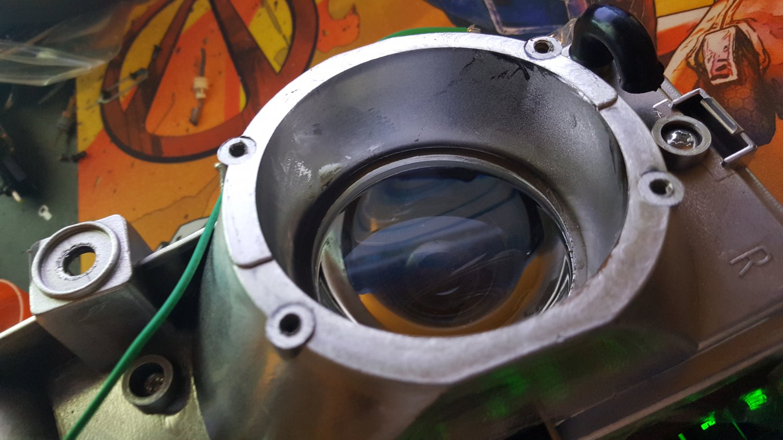

after boring, you should be able to slip the lens and bracket into the housing

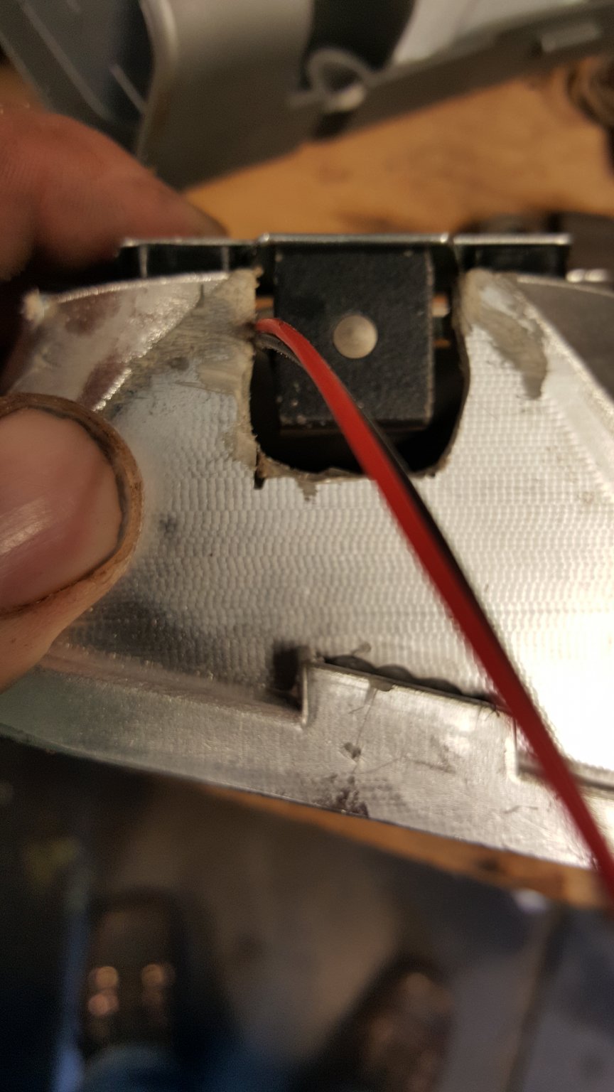

The big deal about a bixenon projector is that the hi and low beam are contained in the same housing, with a shutter to change them over. That shutter requires a notch around the solenoid to fit into the housing.

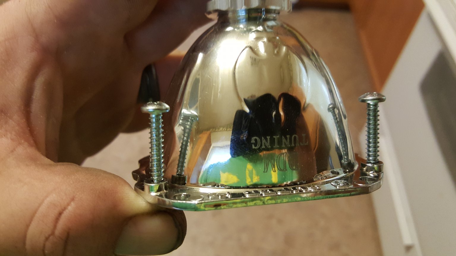

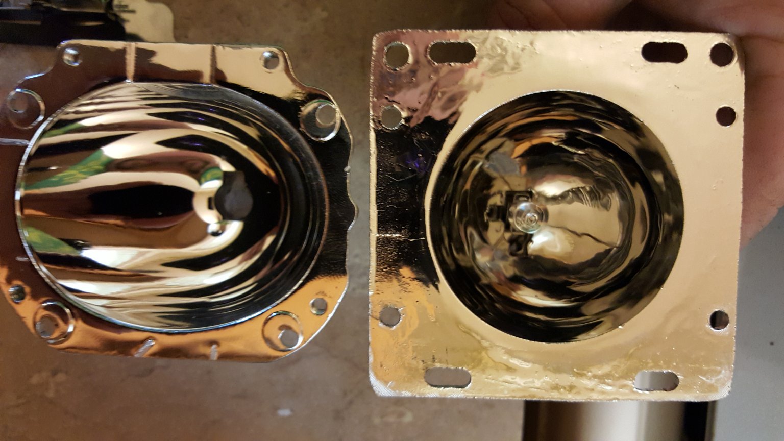

with the shutter fitted, we can start on the bowl, not the extreme differences between the two, DDM tuning on the left, craptastic ebay special on the right. also, note the spacing of the holes, which is what makes this whole thing work as well as it does.

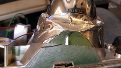

I used some machine screws from a multipack deal from wally world, fitted to the bowl, they're just a bit bigger than the hole so i could have either wallowed the holes out, or do what i did, which was just to run them through to cut the threads into the holes so they were tighter.
tighten them down and seal with your sealant of choice, as these are my test set i temporarily sealed them with heat tape, to be replaced later with something more permenant.

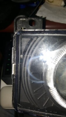

replacing the inner panel should see it fit like the original lens, making them visually no different than the stock projectors when installed.
resealing the lights for me consisted of removing as much of the original sealant as possible, and stuffing the crack with new butyl rubber, heating it again in the oven, and pressing it together CAREFULLY but forcefully and reattaching the clips that go around the outer lens.

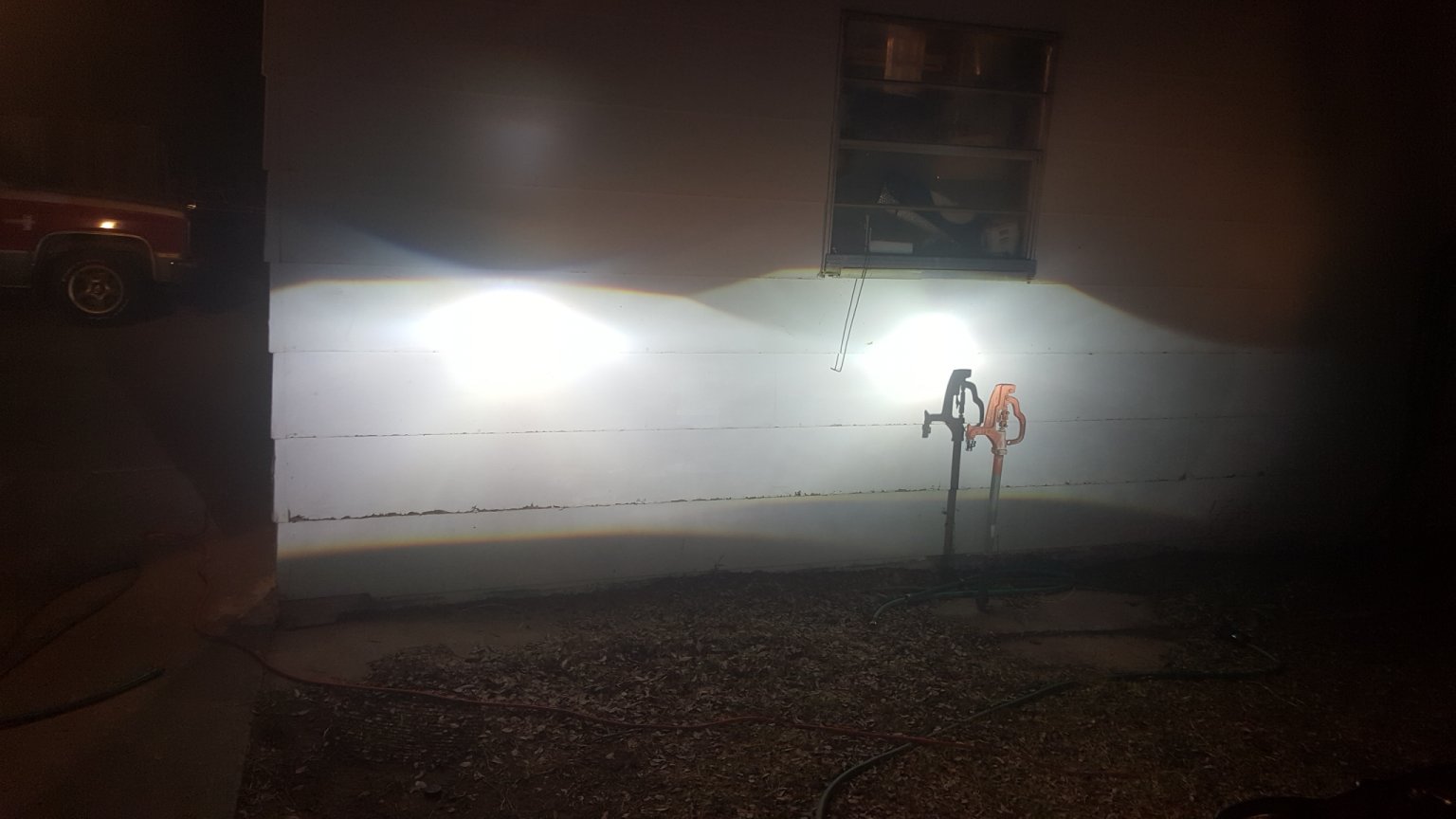

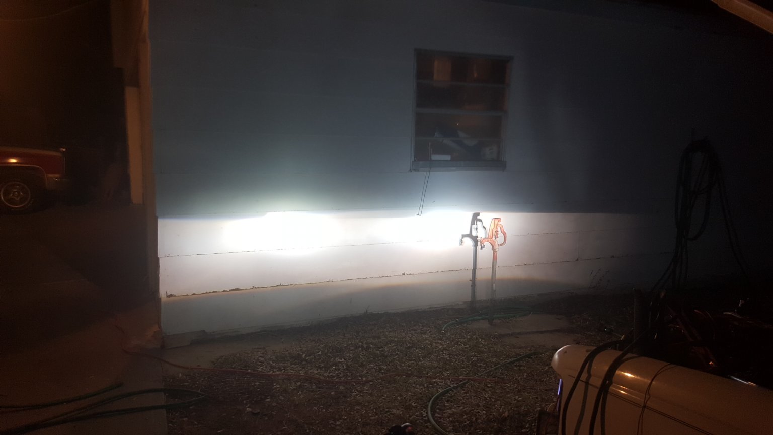

Now that their in, albiet not fully aimed, i'm very very happy with the change
55w 5000k HID H1 style
Low beam:
High Beam:
compared to this asstastic setup with QUAD 55w 9005/9006 6000k HIDs
