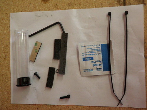

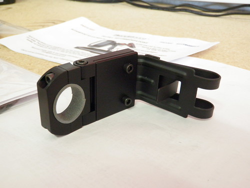

Here is what the kit comes with:
And a close up of the mount...
They supply everything you need:

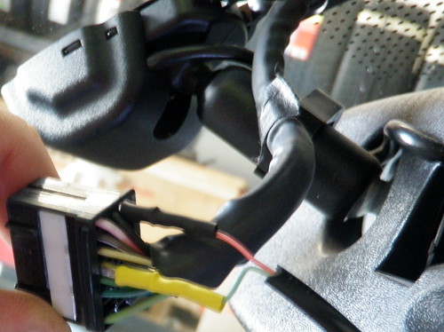

The invisicord:
My Mirror:

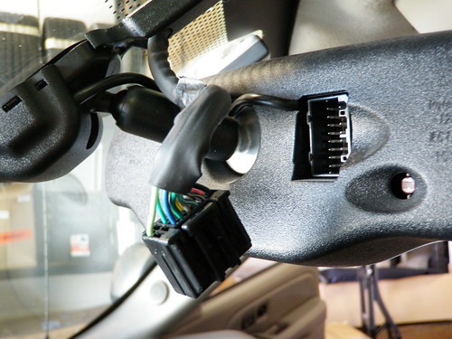

The instructions are great, I recommend starting with the wiring:
Tilt your mirror to the passenger side and unplug the harness (be sure your ignition is off...
Following the instructions and the wiring diagram, simply locate the correct wire and put the ends of the Invisicord into them. *DONE*

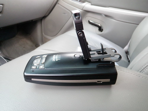

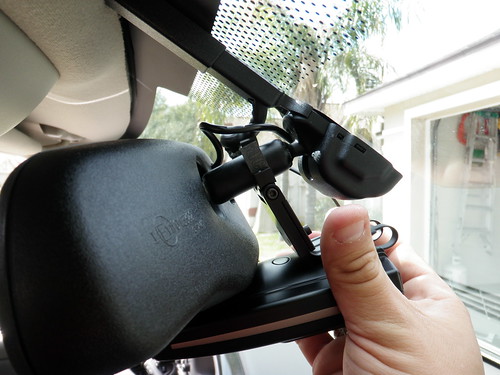

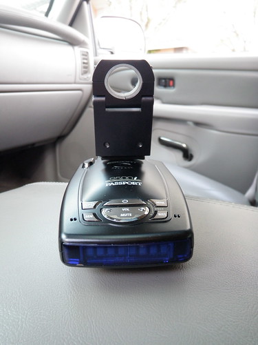

Next, mount your radar on the BlendMount:

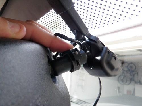

I found it easier to do from the passenger side... tilt your mirror to the driver's side and remove the retianer clip holding the wire onto the stalk.
Now, unscrew the top of the BlendMount from the base, and test fit on the stalk to see if you need the spacer or not (I did):
Now holding the radar with one hand, use your other one to clampm the top back on, making sure to not pinch the spacer...

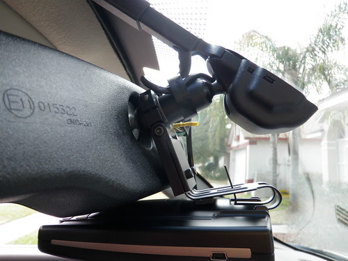

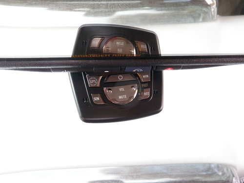

Almost done... That was the easy part.... Now that you have the mount on, you have to align it...
You can see mine was not straight at first... and you can see that yo ustill have access to all buttons, important on the 9500's.
You will have to loosen the top, slightly and move it back and forth until you get it aligned correctly... The hardest part was having to bounce from passenger to driver's side to get it right.
One tip: move the stalk dead straight to the windshield, or the radar will point left or right. You will also need to move the mirror up and down to get it right.

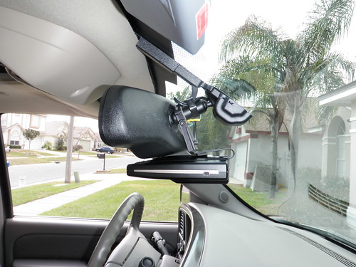

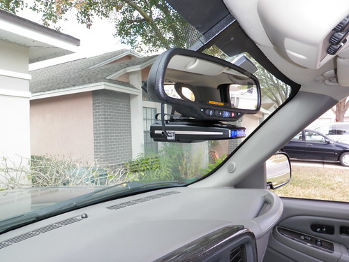

Here's how mine turned out:

Just to play Naysayer, I would like it better mounted above the mirror. Pretty slick idea though. I love making things wireless. Nice write up.
