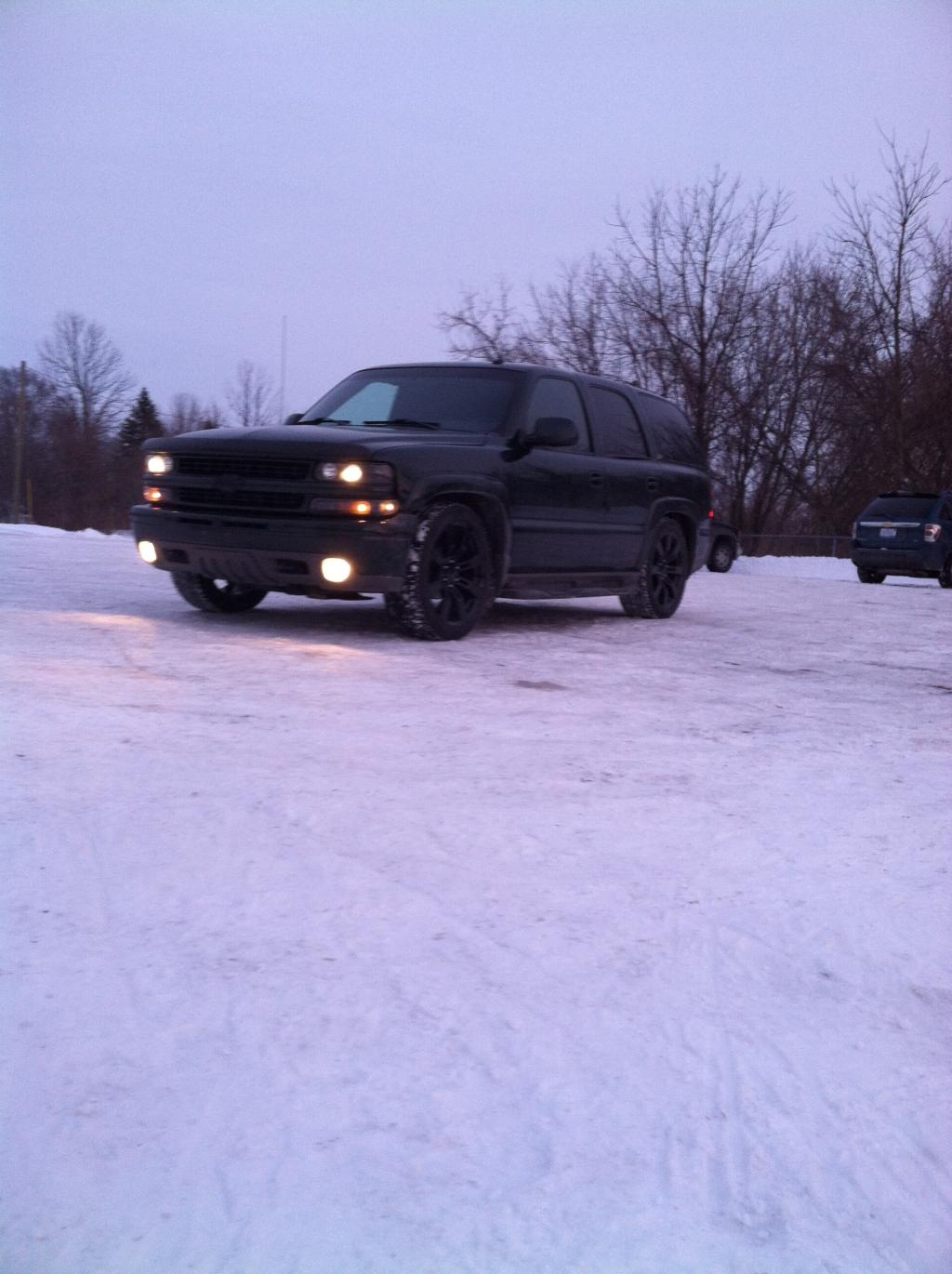

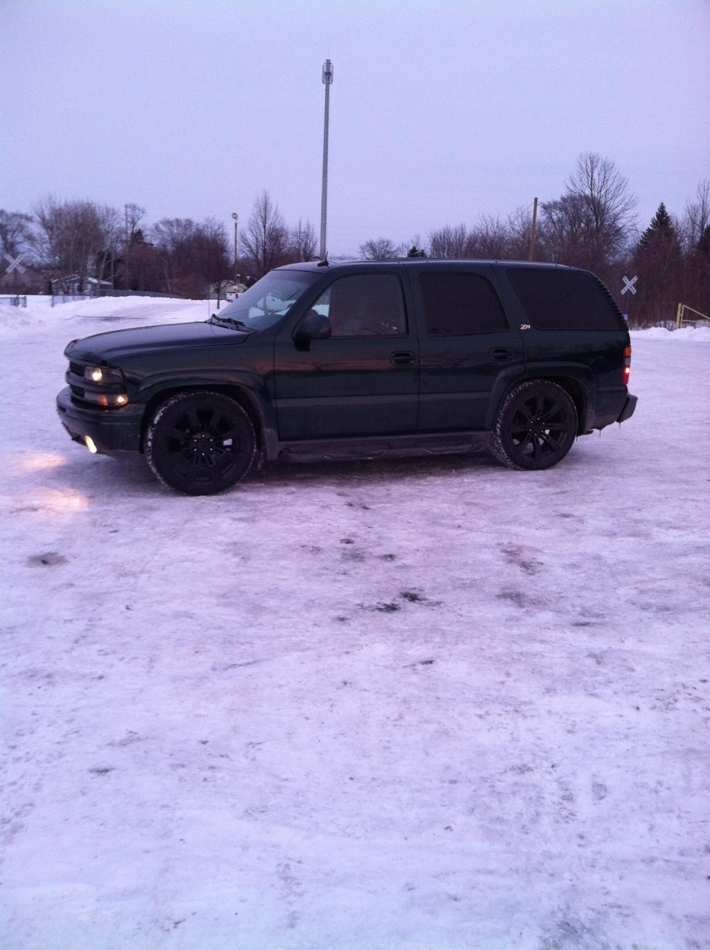

As of right now I don't think I'm gunna keep it lowered. I have a cpillar wall built with 4 18s and 4 gp31 batts in the back with two huge amps. Over 1000lbs.. And the truck rides bouncy. I likes the ride better with stock z71 shocks.. I'm gunna give it a few more days to see if it grows on me. If not take it off.

looks kinda low in back, how about helper bags. You gas mileage may suffer but you will get around better in the snow

What rear set up is it?
Did you cut bracket off frame?
Did you use the shorter endlinks?
Did you use shock extenders?
What Springs?
I can get the rear to ride fine just need to know what you did so I can dial it in

if bumpstop bracket is not cut helper bags wont really help that much becuase there is no travel in rear

It would take away some of the bouncyness he has
you would have to lift the truck so far up will bounce even more. You have to lift it so far up to get it off the bumpstops to get travel so ride will suffer because your running so much air in the bags.
He needs to do other things first before spending money on helper bags because even if he put helper bags in ride still will be bad.

I really don't know. I went to belle tire and spent $500 bucks n this is what I got lol.
