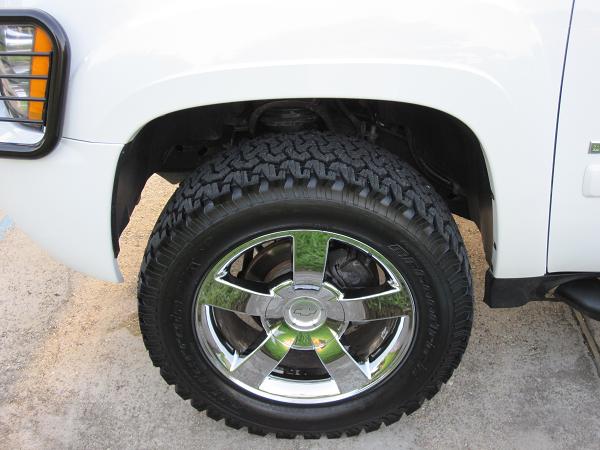

rlewis, ccm is definately the way to go as far as the leveling kit. They are reasonable price and a great product overall. If you want to run 305's your going to have to do a good bit of trimming but all it is all plastic, no metal. When you purchase your rims make sure that you check the offset of the rim because that has a alot to do with he size tire that you can run. The main reason I am running 305's along with the other people on the site, they are keeping the factory offset. Here is a pic of the trimming I did:

Dave I like that pic you posted that looks good. Chances are I'll prob do some trimming anyways, I don't like the way all that plastic looks. How wide are those rims? 8.5? also whats your backspacing like? I know the 20x9 novakanes have 4.5 backspace
