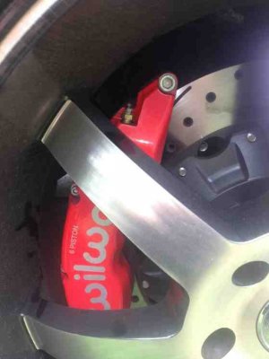

I installed the kit jennait was a very simple install nothing special beside keeping the SS lines away from moving parts due to the fact the they are long and don't have any mounting brackets for mounting. Heres a pic as it sits on the truck. Can my master cylinder brake booster or anything dealing with the brake system be going bad??? I have no light on the DIC ImageUploadedByTapatalk1342208254.204668.jpg
JennaBear
Resident Ninja
Supporting Vendor
May 3, 2009
6,086
241
San Diego, CA
Did the shop do the factory bleeding procedure with a Tech II?
The fact that both your BAERs and your Wilwoods are having issues, lead me to believe that there is another issue. The factory master has never been a problem with these.
