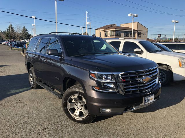

Got rid of old faithful last weekend and picked up a used 2017 Tahoe Z71. I LOOOOOVE the new technology packages that they are putting into these things, and the ride is phenomenal..... But there are 3 issues that I am not sure if they are issues, or just the way the new hoes are.
1) When gradually applying throttle from a stop, she seems like she is sputtering/hesitating. It's especially noticeable when she's cold. I'm not sure if it's a fuel thing or she can't decide what gear to be in, but it's a little annoying.
2) The Z71 seems to have a lot of the bells and whistles of the LTZ/Premier lineup, except the head light seems to be the old yellow halogen. I have the LED strip and what looks like the LTZ housing with the projector bug eye. Can I just pop in an HID/LED into that housing and call it a day?
3) Why, why can't I pair TWO devices to the head unit at once? Am I missing something here?

Put some pics up... i likes pics
