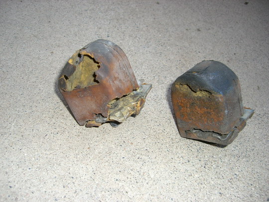

I did the same a few months ago. I searched and searched and ended up going to the dealer. I think rockauto has some, but there are a few different ones depending on your VIN.
Mine were both totally trashed as in wasted, gone, half eaten away. It looked as if they were like that for maybe 5-8 years or more.
As I was replacing them, I noticed that the one side was worse. I looked closely at the "dish" that they contact on the control arm and found lots of little balls of weld slag stuck to the dish area. (made in the USA?) I took a chisel and knocked them off easily.
Had I not done that, Im positive in 5000 miles they would have been toast again.

Here are the old ones, I kept them to take a pic.
