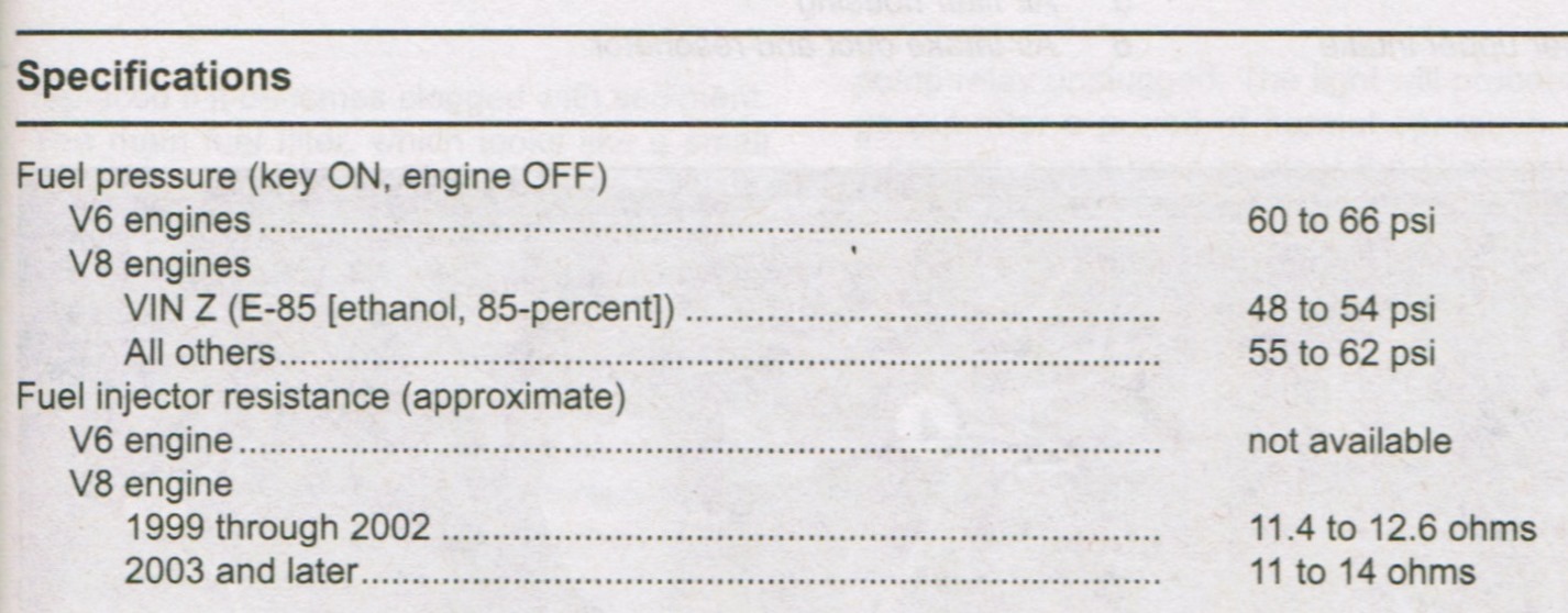

So I got a fuel pressure gauge finally. And I'm thinking I have a bad fuel pressure regulator. Tell me what you think.
While cold, turned key and the pressure went right up to 50, truck started no problem and ran at a consistent 50psi.. Goosing the gas cause a split second drop in pressure with an immediate return to 50.. Turn the truck off and fuel pressure dropped immediately to 20, then slowly the rest of the way to zero. Turning the key pressure went right back to 50, but immediately dropped after the pump stopped running (did not start it that time).. Repeated this test a few times with the same results.
Removing the vac line from the regulator made no difference in psi at all.
Let truck run to operating temp, then let it sit for 2hrs and then turned key. No fuel pressure, in fact it took 4 turns of the key to start getting pressure then two more to get to 50.. After that running psi I was 53 and everything was the same.
Used a stop watch to measure psi drop this time 15 seconds from 50 to 20, 45 total seconds 20 to 10 and about 2 min total time to 0...
What do you think ???

^^^^^ Definitely something to try. And the pressure shouldn't be leaking down that fast. Depending on your particular engine and VIN, the working pressure might be low. Or not.
