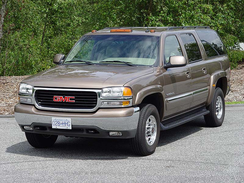

Correction, only Quadrasteer 2500s had the cab lights. That is due to the added width of the rear. With that you need clearance lights front and rear (one at each side, and three in the center). Notice the larger fender flares and lights on the rear of the Yukon in your picture. They also have an additional clearance light above the high mount stop light on the rear, see below.
