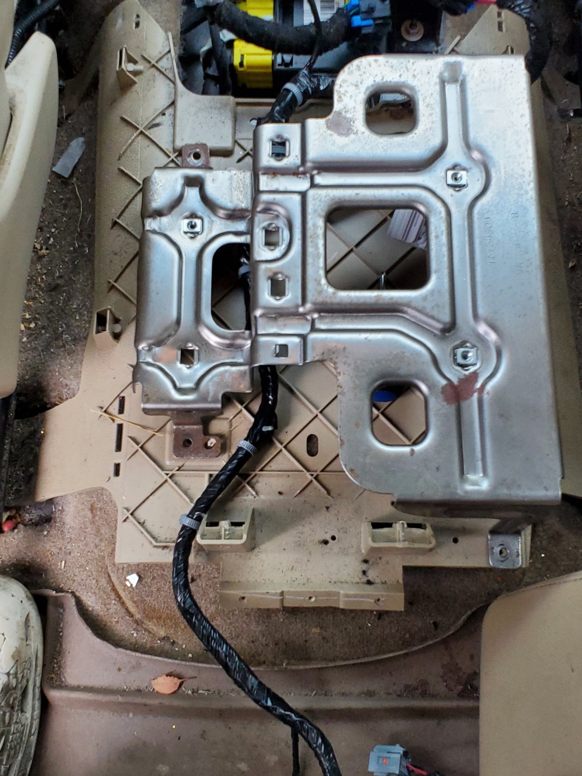

The LT trim level will have the dumb amp, not the one that includes the center speaker on the dash.
If you pull out your cup holder and tray you can see the amp underneath along with the subwoofer and old french fries, sesame seeds, dried up coffee...

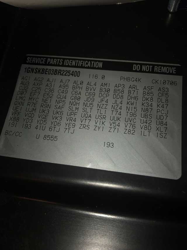

If interested, post up your "U" RPO codes and I'll decode them for you.

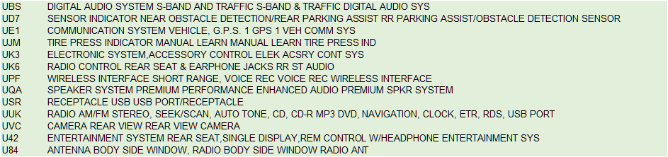

Any idea what that UPF "wireless interface short range" could mean? It almost sounds like bluetooth but my truck doesn't have bluetooth. Maybe the headphones for the rear seat entertainment?
I have that code too and do not have a rear DVD system. I believe it is Bluetooth, you have it to connect your phone to the vehicle's communication system so you operate your phone through the steering wheel controls and onstar voice commands. Our radio/navigation units also have voice recognition but I've never figured out how to use it or even if it is active. Bluetooth was added in 2009.
