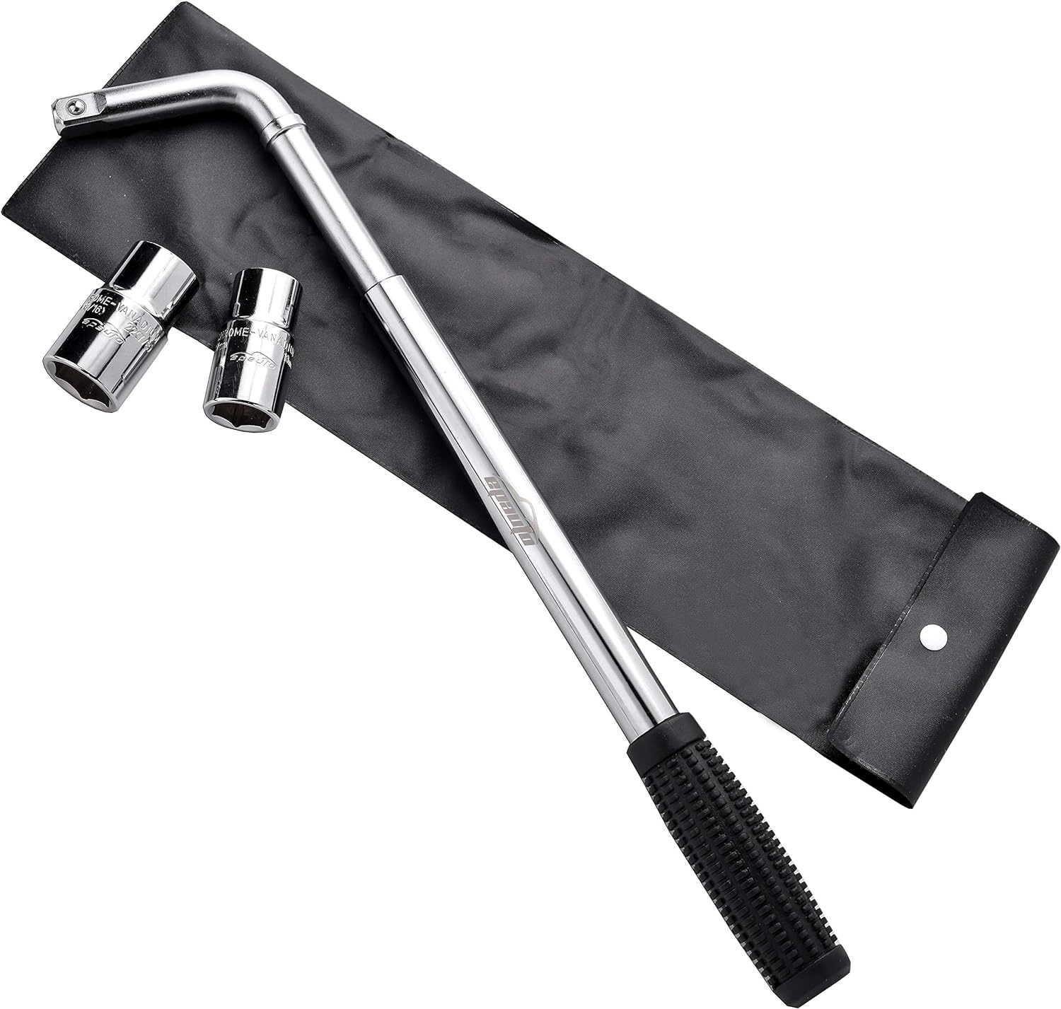

My daughters have done it with the folding lug wrench I keep in the truck. I bought the Gorilla brand but it can be had in a dozen different brands and at less cost.
Even in my weakened state I can still crack them loose with it. Thankfully, we haven't had a flat in years, just tire rotations at home.

I’ve never had an issue breaking them loose with the factory lug wrench.
140 ft-lbs with an 18” wrench, 100 lbs or so applied to the end of the wrench should break it loose just fine.
Taught my kids, including my 15 yr old daughter how to put the tool horizontal and step on it while making sure they kept their balance.

it can be done there is lug wrench in the back drivers side panel and a jack and the adapter pieces to get the spare down.
How to do it is shown in the owners manual.
if you get it out and try it (practice run) and for some reason just can't get it to break loose then grab yourself a breaker bar and keep it in the same storage space as the jack.
a good choice is about a 12-14" long piece of 2" galvanized pipe (found at any hardware store)
problem solved forever.....
because when the time comes and you actually have no choice but to get out there in windy, freezing, raining, mud, miserable as any person could be your going to want it to work.
pro tip: toss a rain jacket or poncho in that same compartment. you can thank me later.
