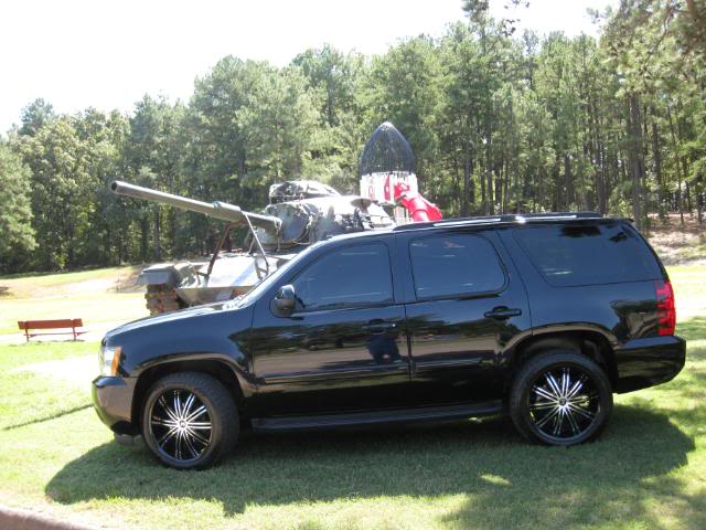

Well I just sold my 22" wheels and now I am looking for something a little more aggressive. I am leaning toward a 2.5" leveling kit (not sure what brand) and a set of 18" wheels with 305/60/18 tires all terrains. The Tahoe is 2 wheel drive and will never leave the pavement so this mod will be totally cosmetic.
I found a set of Black Gunners 6 local that are 18x18.5 with a 25 offset. Honestly I am not sure what the 25 offset will do as I have read some people running a +18 offset. I do not want any rubbing when I turn or have to trim away any of the inner fender.
Curious of others thoughts and opinions on the mod and if other have had success with it. Also what would a 25 offset give me compared to a +18?
Here is how my truck did look. Now I am on 17" stockies.
Thanks Guys.
