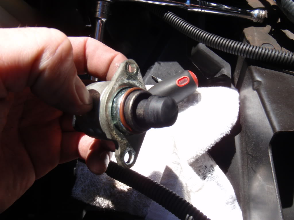

locating it and pulling it off
not the worst ive ever seen
hard to see the carbon build up..but its the

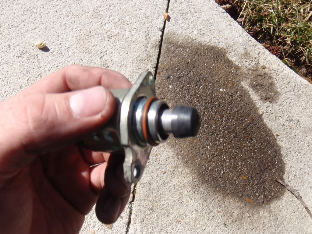

after carb cleaner and a steel brush

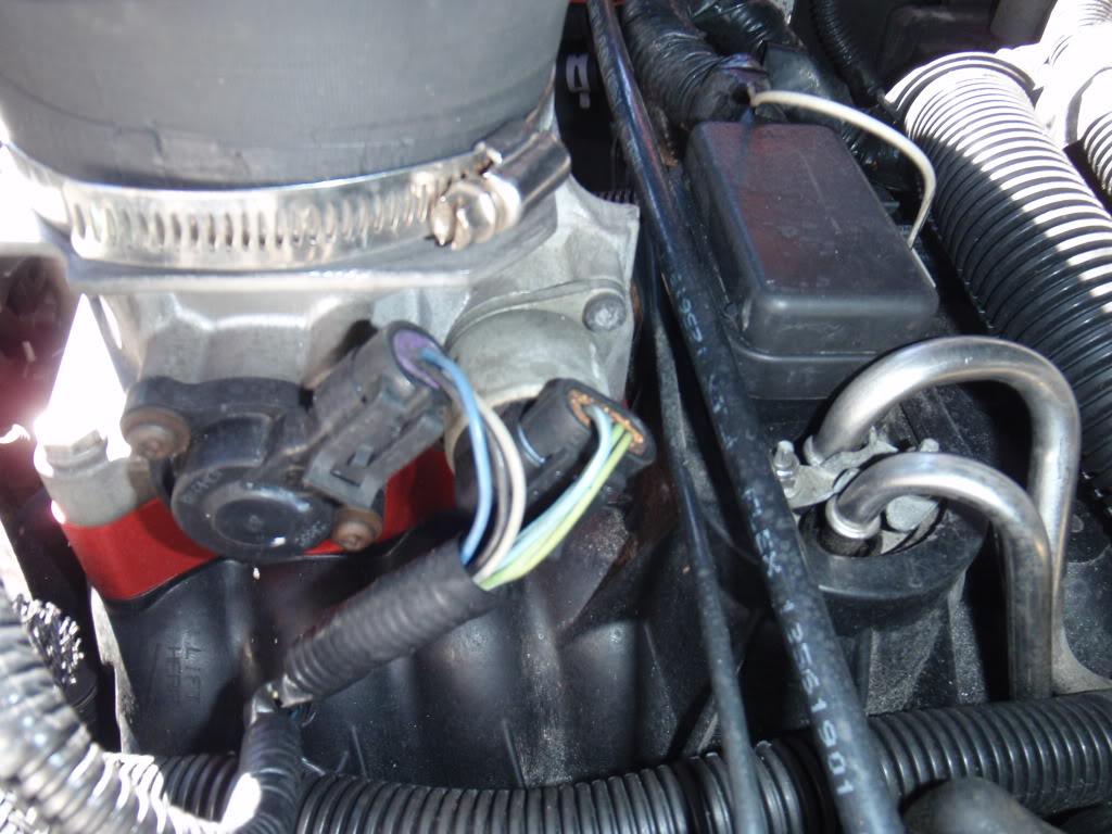

and while i was there as might as well clean the intake
NOW its smooth as butter

What is the iac? and how did you clean the intake? I would be afriad of stuff falling into the open intake. or should I not worry about it
fyremanpat
fyremanpat
Fyremanpat
Feb 4, 2010
478
757
just use carb cleaner. and unless you have massive chunks of carbon you will be fine... Idle Air Control valve

after the egr and iac....huge difference in throttle response....enjoy!!!
