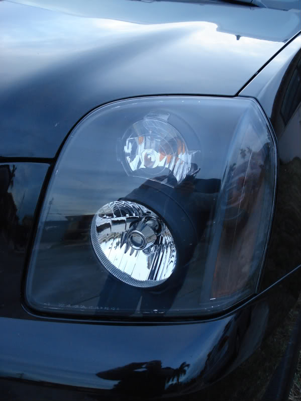

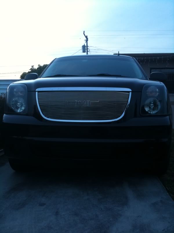

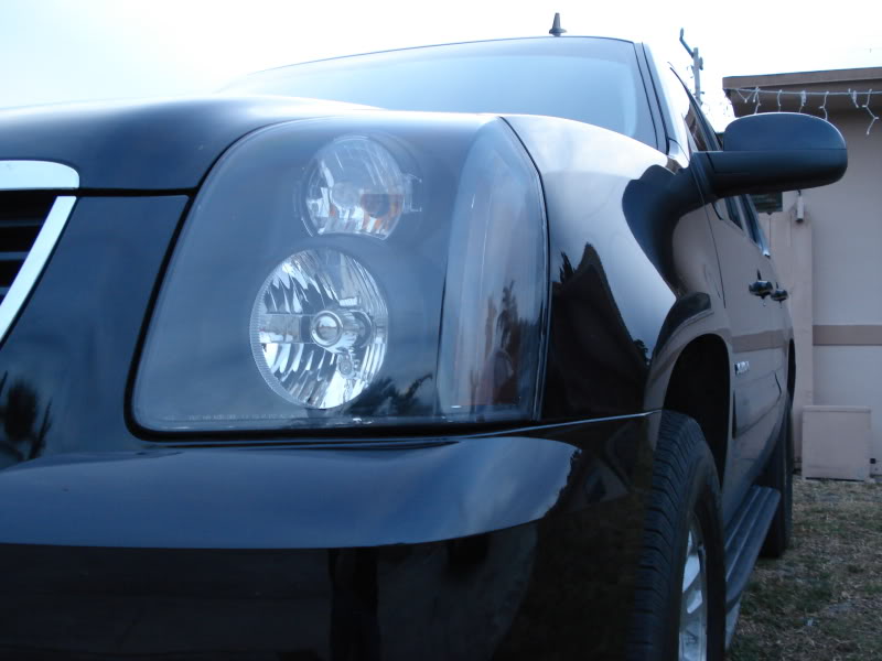

I did the black housings on my yukon, and blacked out the orange on the side. it isnt that hard, I've done about 7 black housings. Use a heat gun or hair dryer to take them apart then use high temp silicone to seal the back up..
