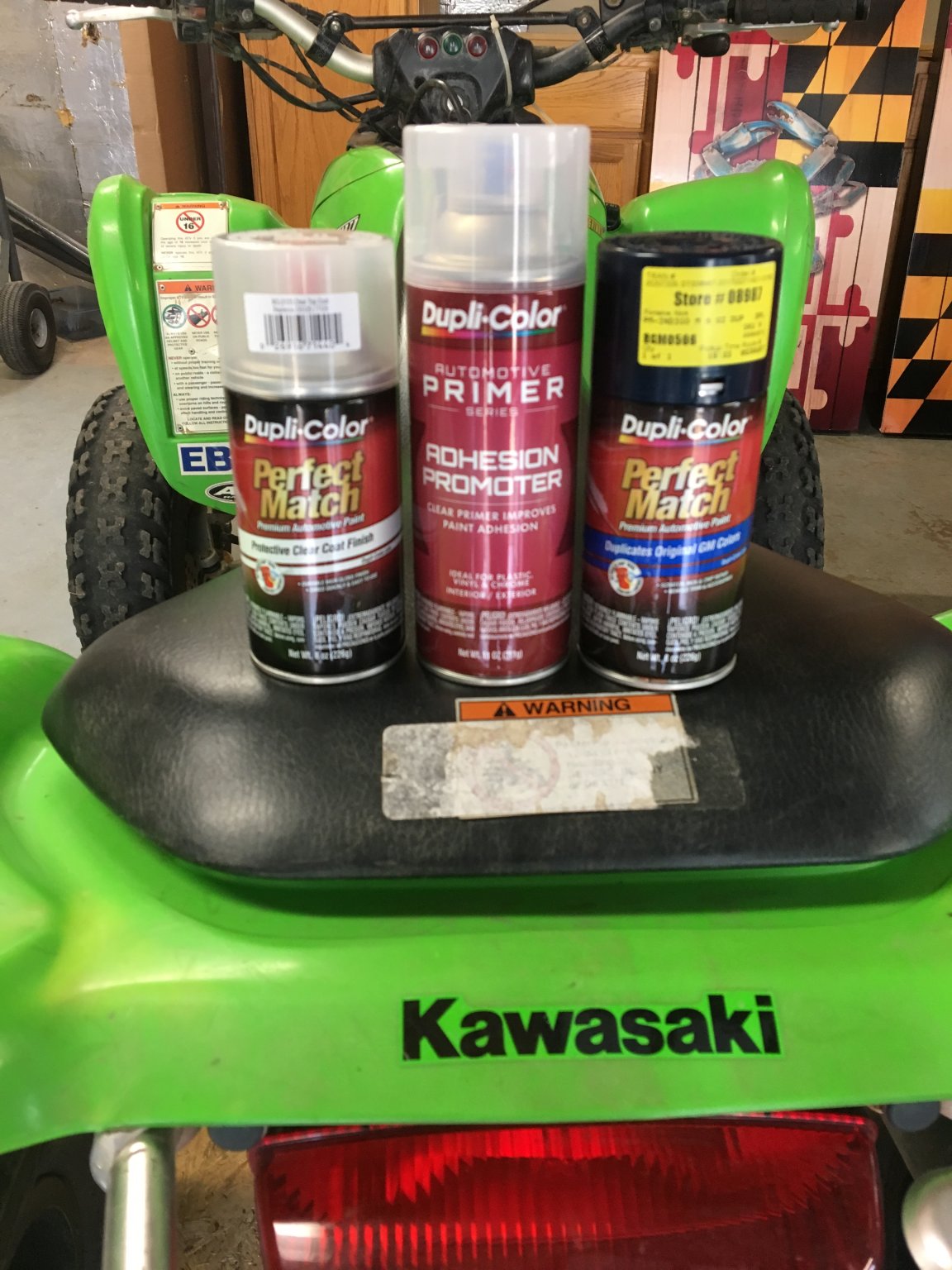

After days of searching how to color match plastic car pieces, which would be our black textured plastics (door handles, bumper cap for front and rear, lower valance, and fender flares) I did figure out how to do it, so I'll share what I did to help anyone planning to do this and wants to save money.
What you will need
1. 220 grit sandpaper
2. 400 grit sandpaper
3. 1500 grit sandpaper
4. Duplicolor Automotive primer adhesion promoter
5. Duplicolor clear coat
6. Duplicolor color matched paint. I got mine at advance auto. If they don't have the color on the shelf just go on duplicolors website and find the part number and ask them to order it for you.
It cost about $35 for everything

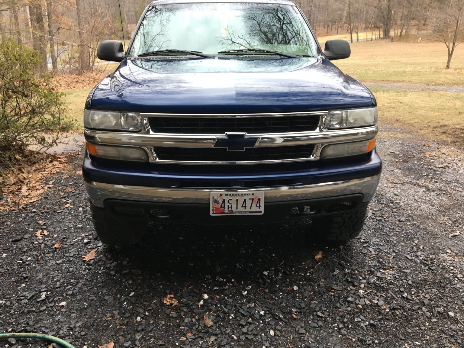

My finished bumper cap. Took a total of 5.5 hours
