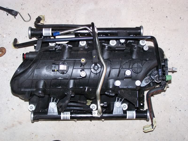

Since we are on the issue...I heard that the 6.0 and the 5.3 used the exact same intake manifold, throttle bodies, and headers.....can someone verify this? also, what else will work? I'm assuming that a/c compressors, alt, and ps pumps are exactly the same as well.
