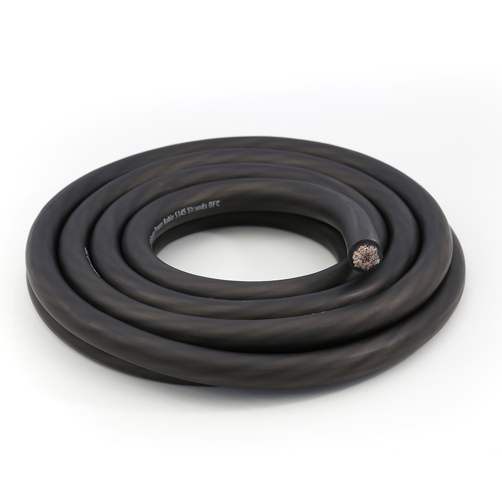

I would only use copper. Size the wire for the length & amperage, then consider the wire and the connectors as a system. I prefer using solder terminals that utilize solder pellets, then sealing the joint with heavy-duty adhesive-lined shrink tubing.
Some sources besides those mentioned above:
