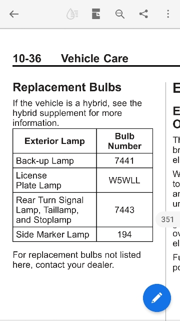

I have a 2011 yukon denali and saw a bulb was out but when I went to check it had no bulb # on it. online gives me the option or 7443 or 3157 and just wanted to be sure of the right one. I'm assuming the parking turn and brake lights are the same bulb #? and the reverse is 7441?

7443 and 3157 are entirely different bulbs and will be easily visually different. size shape and socket style are all different. just take the bulb with you into the store unless your buying it online. if your buying it online post a picture of the current bulb and i can tell you which one it is.
My 2012 manual lists these bulbs...
looks like a 7443
