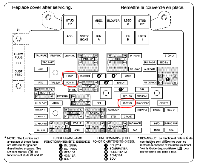

There are many good YouTube videos on parasitic draw (South Main Auto, for one); if you haven't tried the "voltage drop across the fuse test points" I would highly recommend it. Also, interrupt the negative cable with an ammeter and watch the draw as the modules go to sleep (or don't go, as the case may be). Be careful about not starting the truck or using accessories with high loads -- the ammeter needs to be capable of handling the current. Your target draw asleep should be under 50 millivolts (0.050 v) and will probably drop to 30 mv or less if all is well.
For the voltage drop measurements you'll need a chart showing the calculated amp draw based on the fuse style and size. Shout if you need a link to those charts. Pay particular attention to the IPC/DIC, PCM 1 and PCM 2 fuses circled below, but check all of them that have the test points.
If either of the PCM fuses show current draw while the truck is asleep, pull the PCM connectors and check for water migration. Also clean with DeOxit or similar if you have some.
If you have the AUTO HVAC head it can take 3 or 4 hours to fully go to sleep. Also know that the main battery cables can rot out from the inside and not show that on the jacket, so they may need to be tested.
