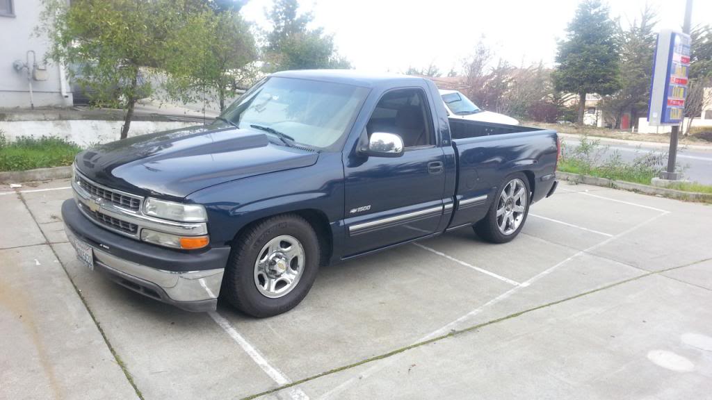

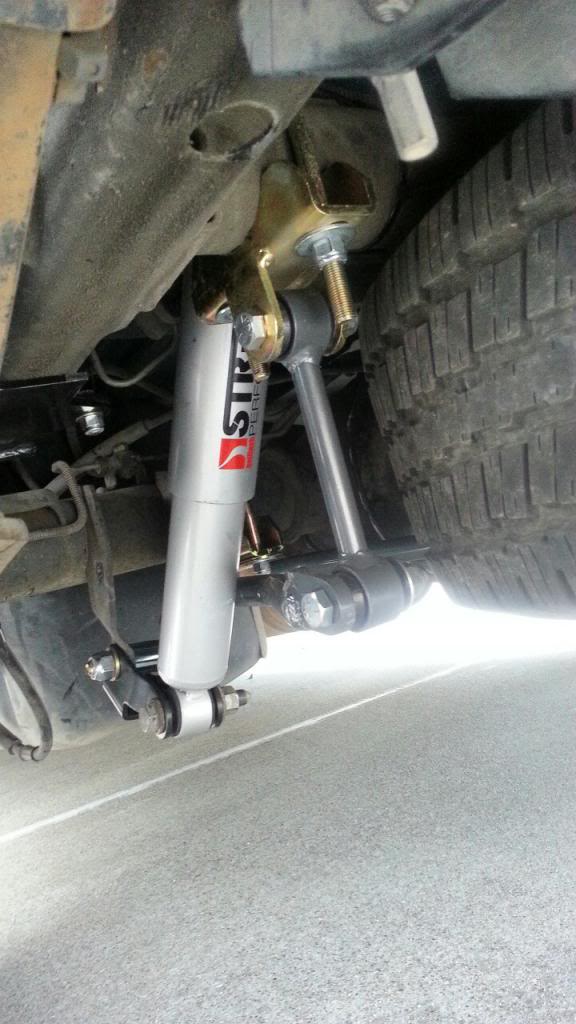

Just finished up this truck and will be a customer project for a while.
Parts i set him up with
FRONT/REAR BELLTECH SP SHOCKS
FRONT DJM 4 INCH LOWERS
FRONT BELLTECH SPACER FOR GM LEAN

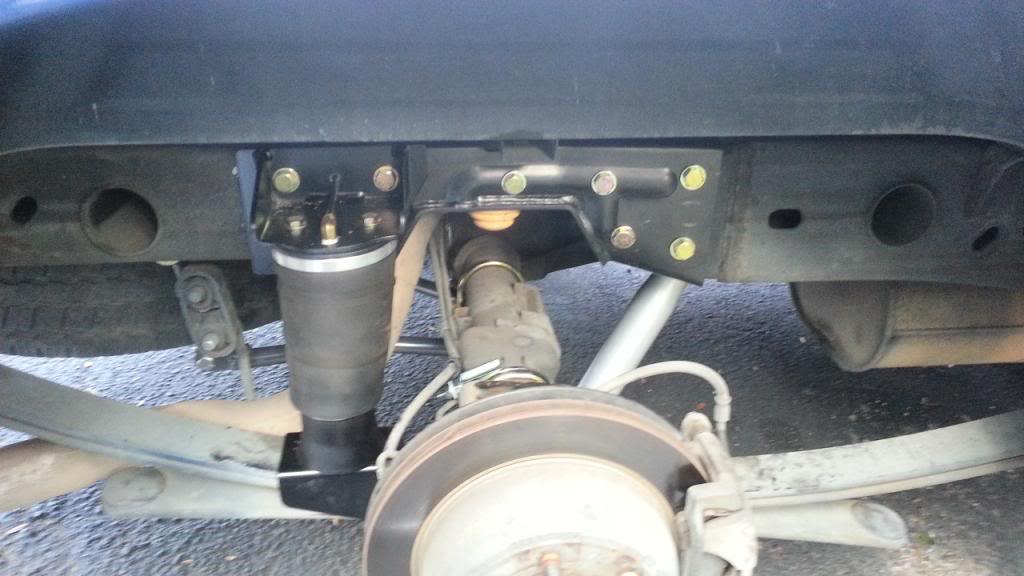

REAR BELLTECH 6 INCH FLIP KIT
REAR BELLTECH HELPER BAG KIT
REAR DJM SWAYBAR
The truck handles extremely well for sure now and Mario thanks for letting me take the pics.

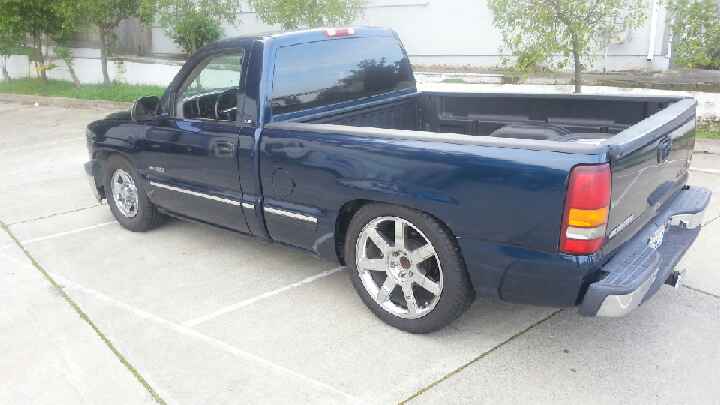

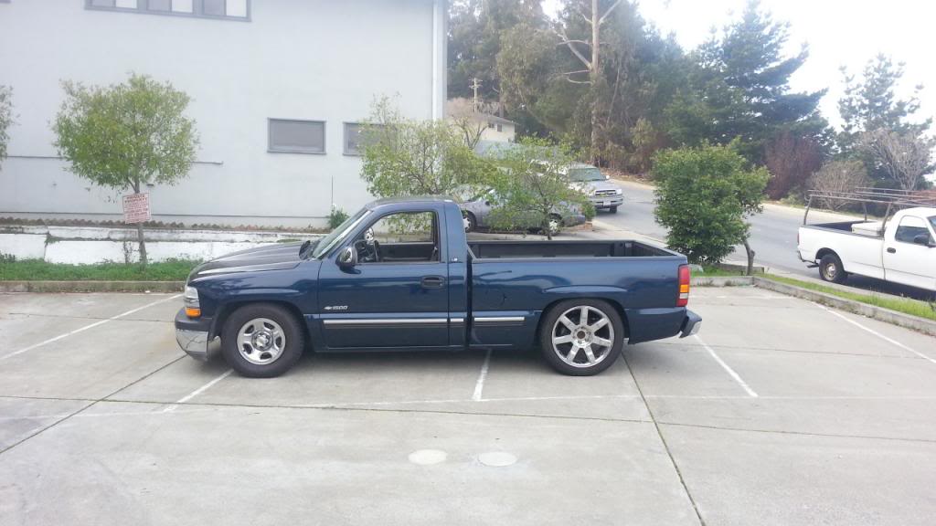

Wheels at this time I will be doing a 22x9 Escalade replica or going to set him up with the tbss 22s but prob will have to roll the rear fenders (esp right rear) since they stick out 9mm more.
Tested the 285 45 22 on the rear and prob going to be widening the rears from eric vaughn which is used for these projects where my customers want shock wheels widened. Im prob going to bring it out to a 10.5 and 305 45 22.
In front going to prob go 265 40 22 on the 22x9
Heres a few start pics as it goes along ill add more
