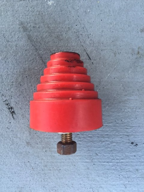

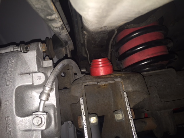

You referring to these little guys? Mine are the polyurethane ones. I cut off the top to give it more clearance from the frame. I do have the free travel mod and those three notches cut off made a world of difference in travel. I ran with that 1/2" you were speaking of initially and I was always hitting the stops. I removed them, cut off so that 1.5 inches from the bottom of the stop remained and it rides much better. Hope that helps a bit even though we are different year set ups.
@Milz77
View attachment 60980 View attachment 60981
I have the dense foam ones the go into the OEM bump stop bracket the come with the Belltech kit, shorter than OEM but still install in the same place
