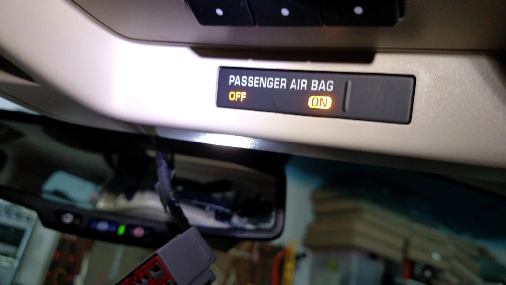

The passenger Air bag light is my target!

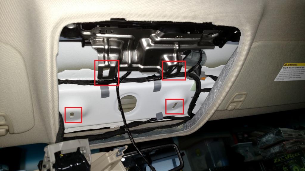

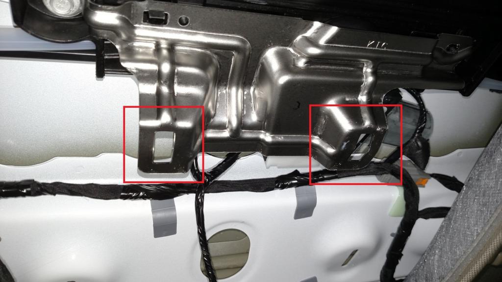

My first challenge was to remove the overhead console. it seemed to be screwed in, but in fact it was not. There are 4 push connectors that keep it secure. The two closer to the sunroof are the hard ones. I ended up opening the sunroof and using a large flat head screw driver to help pry them out.
Close up of the problem
And

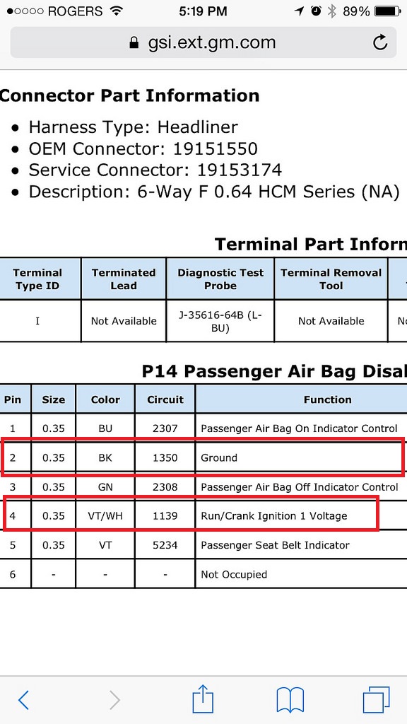

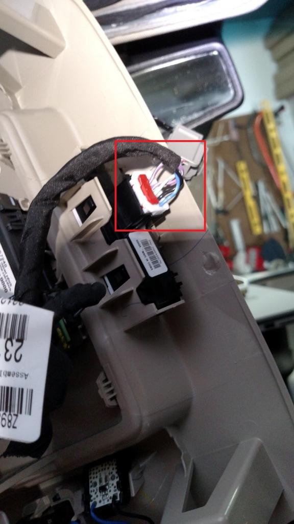

Once removed, this is my target connector. Just use a small flat head to pry up the orange connector which allows the connector to be disconnected. Removing the connector allows you to strip back the wire cover and tap into the wires easier.
These are the wires we want to tap into

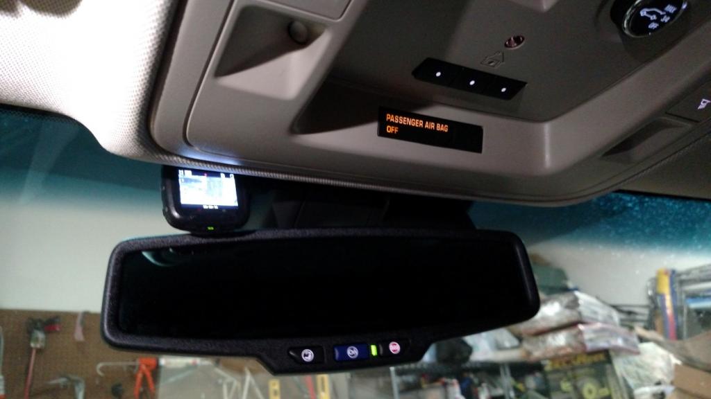

I didn't take pictures of how I mounted the actual dash cam. It would vary on your model, but that part was the easy part.

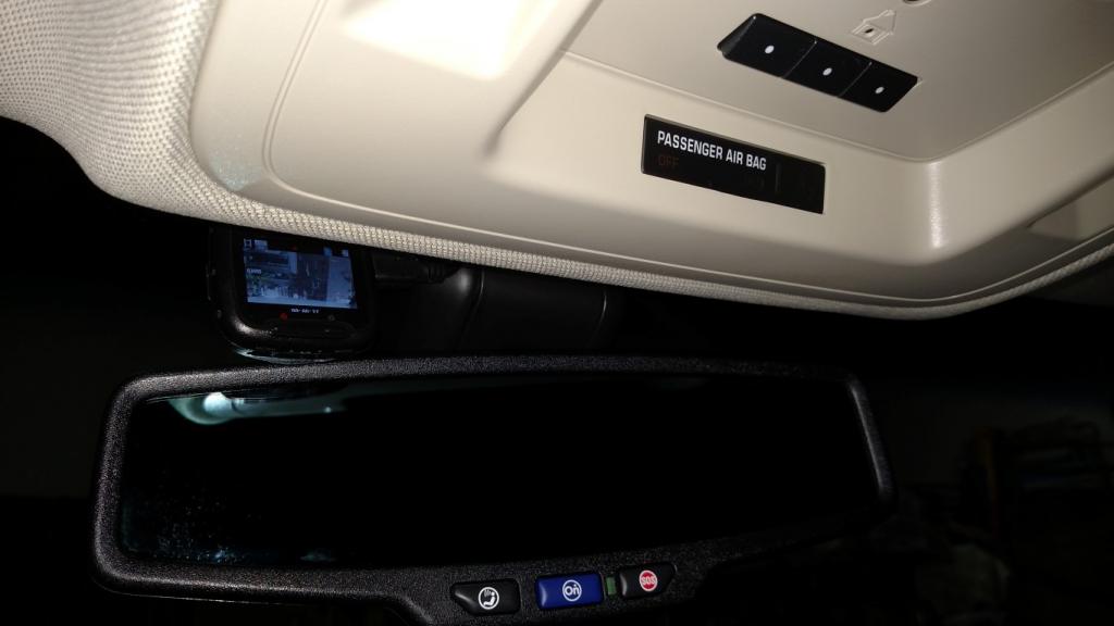

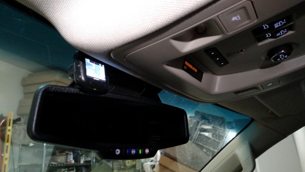

Here are several photos of the after. Enjoy!
