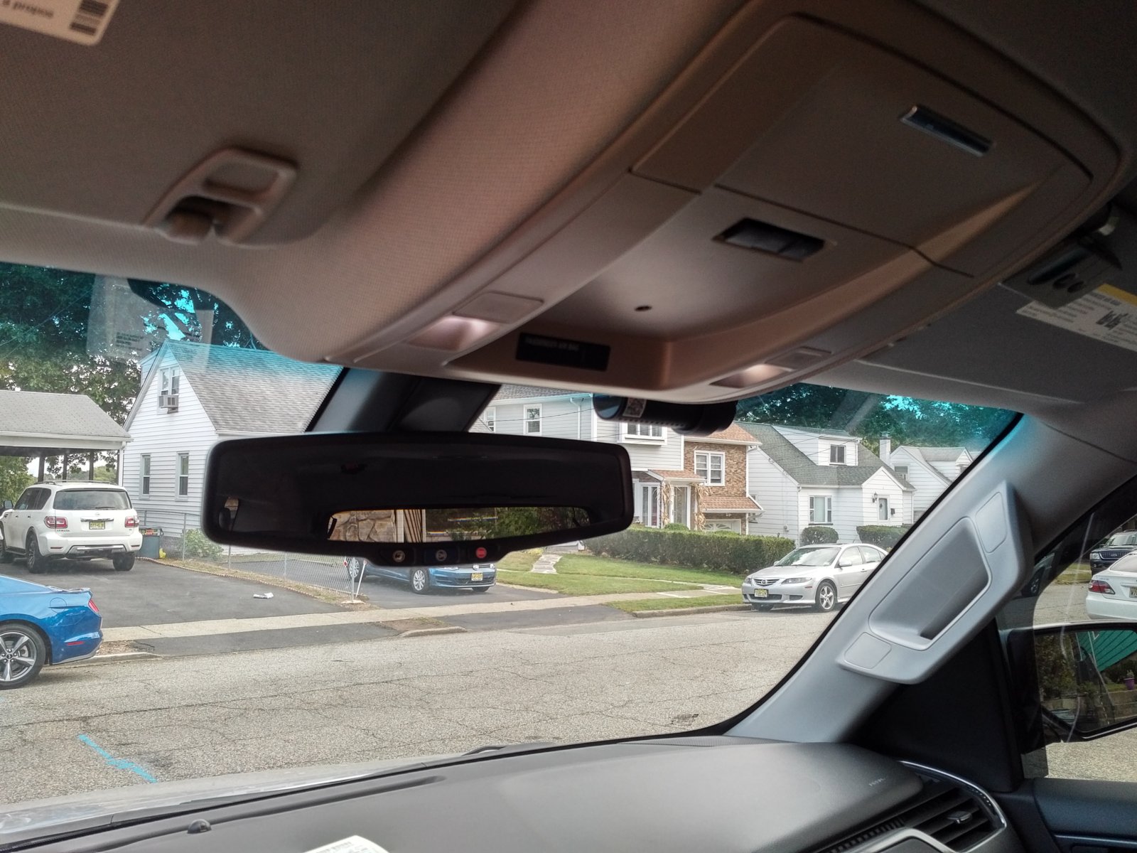

Has anyone installed an aftermarket Dash Camera on a 2015 and up Yukon/Tahoe? I'm looking to put one on my 2016 Yukon XL and can't decide where to put it. The area on the windshield around the rear view mirror is pretty much taken up by the components for the forward collision alert. I would like to have it installed in an area where it is not too obvious.
Also would like to know which cameras have been installed and are you happy with it?
Thanks

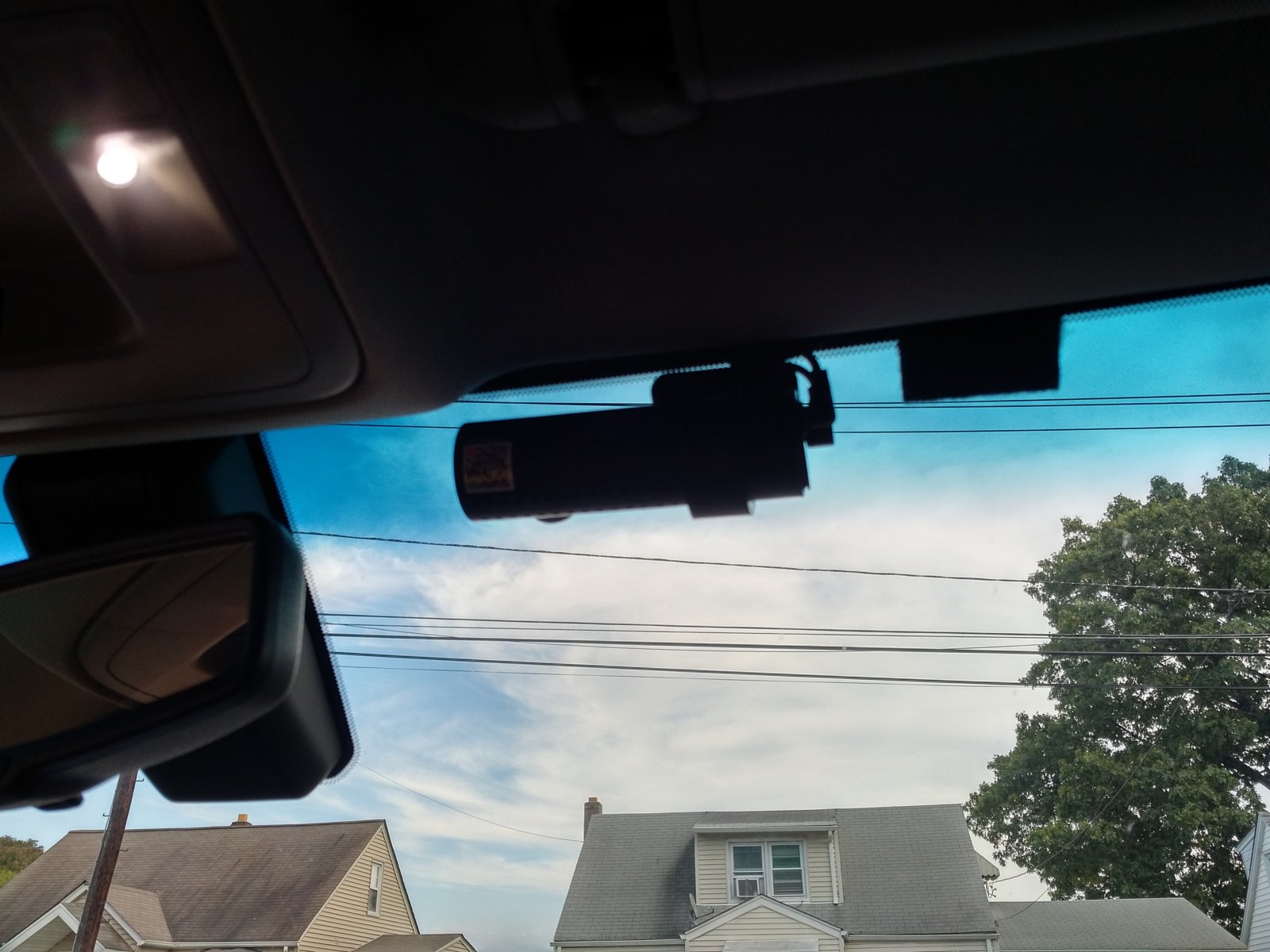

I just now stuck one of those round disks, that they send with gps units and such, to the plastic housing under my front camera sensor. Then suctioned the cam to the disk. We'll see how that works out in the long run.

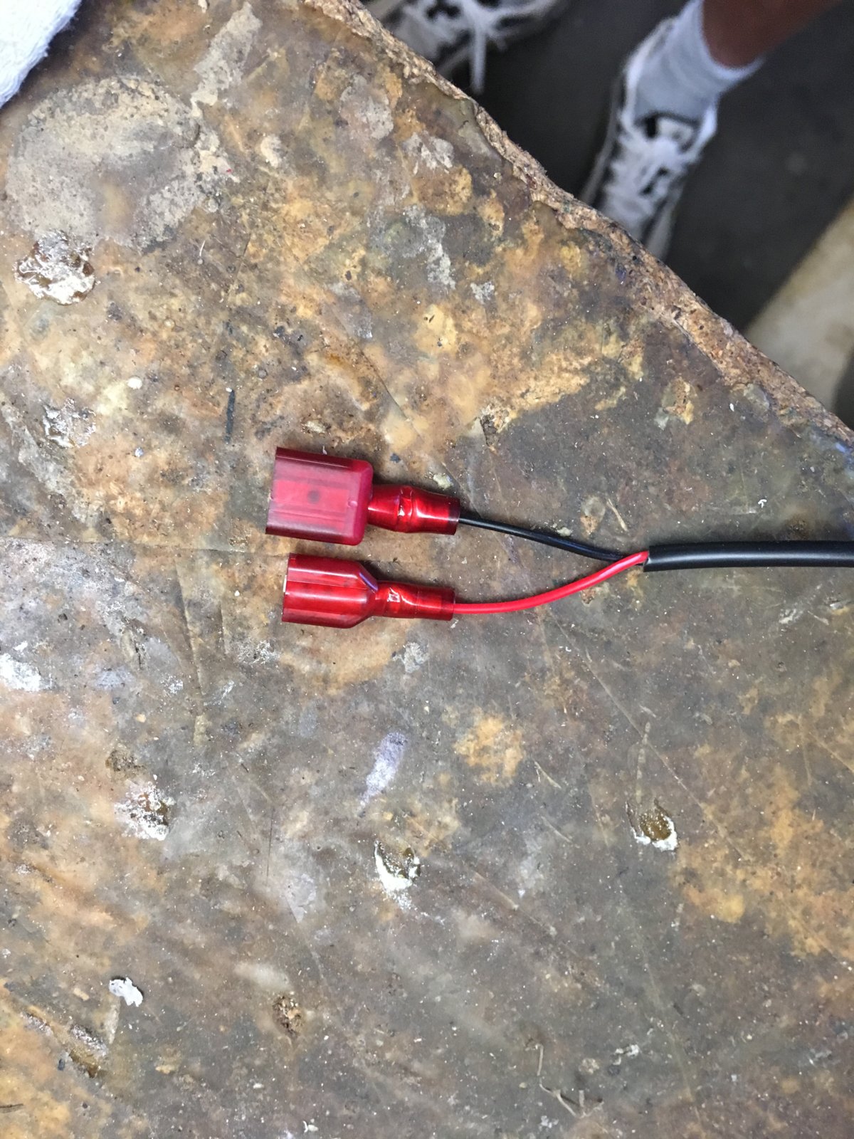

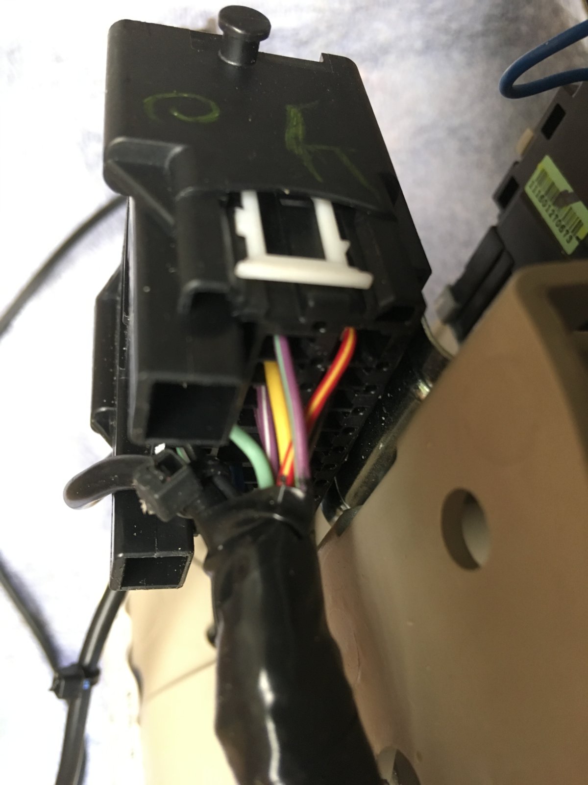

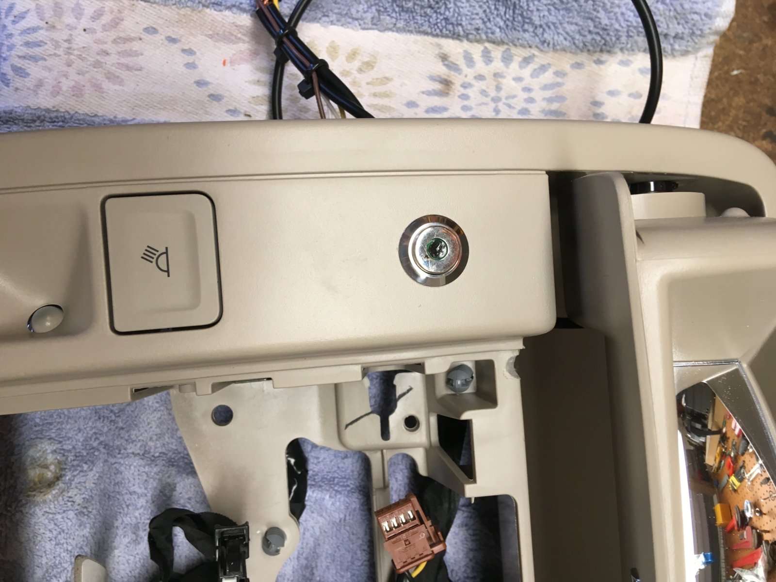

So far, it's working great. I wired up a 5v USB mini-male (adapter/converter found on amazon) to the 12v found in the overhead console. Red w/ yellow and black that go to the homelink system.

Whoa, so you didn't have to run the dash cam cable all the way down to the accessory power ports?! Can you link to the parts you used and by chance any pics or step by step guide?
