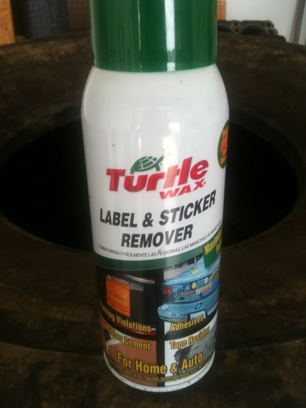

I used Turtle Wax label remover to get rid of the tape that was left.

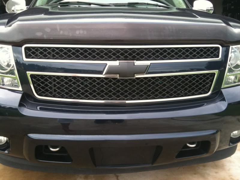

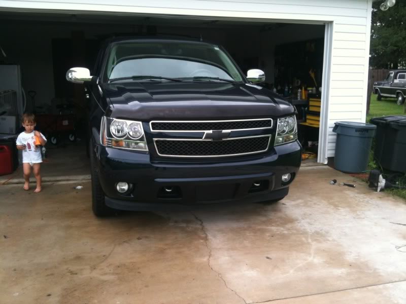

It was a lot easier than I thought it was going to be. Just spray on, wait 2-3 mins, wipe off. I didn't have to use any more pressure than I would on a stubborn stain while washing it. Took 4-5 applications per letter. About an hour later, both sides looked like this:

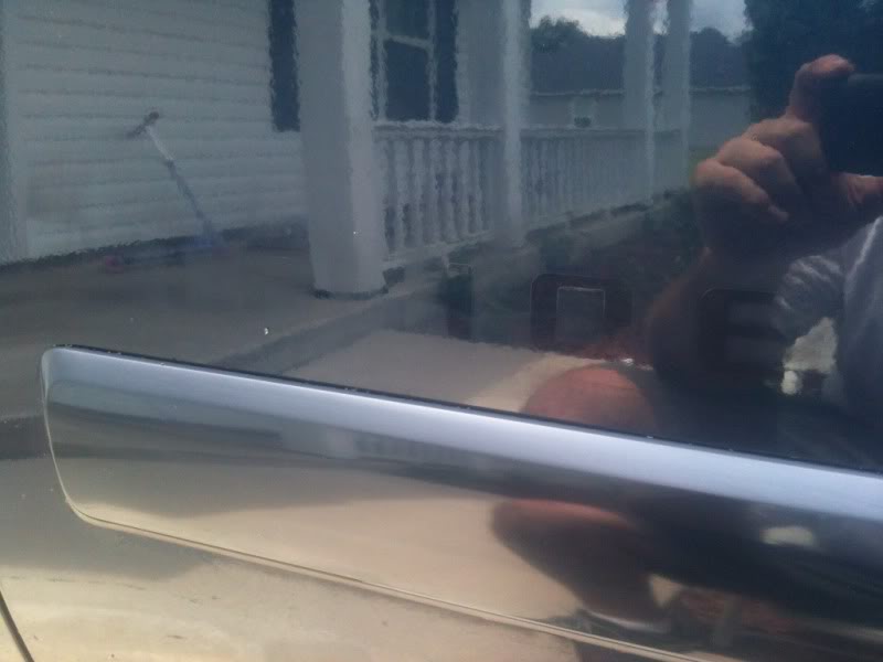

Now this is a 2007 Tahoe, so I have a lil ghosting if I get the angle just right:
What's the best way to get rid of this?

I removed my emblems off of my black 07 about a year ago and it did have some ghosting like that. I just did a full detail with my PC7424 polisher and I can't see the outlines anymore. I'm not sure if you could get that out by just hand polishing though.

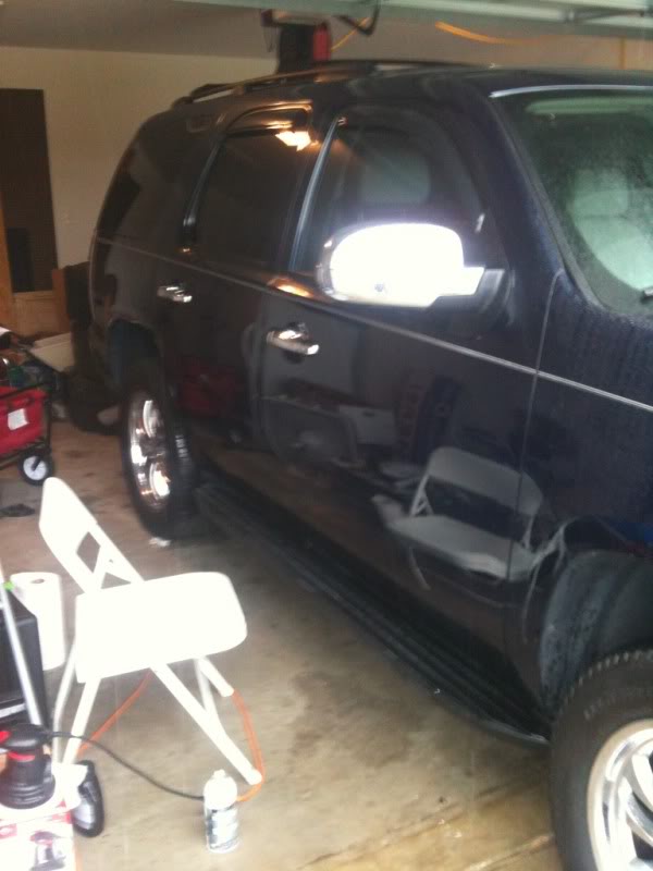

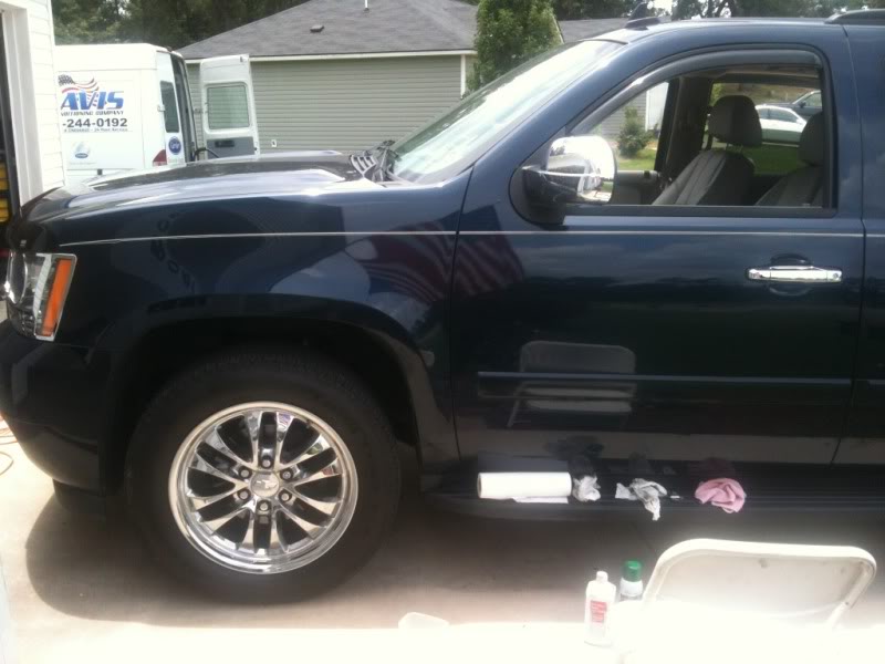

I finished debadging and decided to go ahead and remove the moldings too:
Sorry for the bad pic, it is raining outside.
