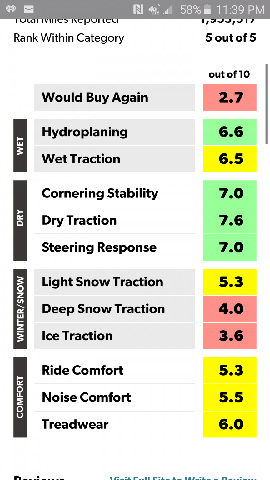

I'm not sure of the tire size but pretty sure your denali has much wider tires than your jeep did. The wider the tire the more chance it will ride on top of the snow rather than dig in. That paired with low tread and the fact that even with good tread goodyear ls2 have a horrible rating in everything.Screenshot_2016-03-07-23-39-58.png
