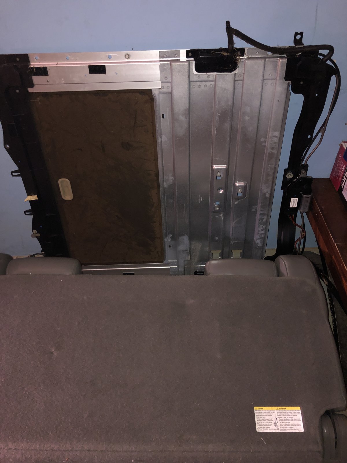

First off, hello and welcome. Read your introduction thread! Anyways the GMT800 design for the sunroof is terrible on GM’s part. It looks like the widely common failure issue that will plague every GMT800 SUV with a sunroof at some point in its life. My 2006 did it a year and a half ago. The family I live upstairs from has a 2005 escalade esv and her sunroof got stuck all the way open like yours did. It happens because all the track and slide mechanisms that attach to the glass and move it along the track, are made from cheap plastic. They get brittle after use and eventually snap. And the reason the sunroof won’t shut is because when a piece breaks, it will lodge itself somewhere in the track, and then when the glass finds the broken bit, it snags on the bit and will get stuck. I got lucky in that the broken bit was in the front of the track, and the sunroof wouldn’t open beyond its first little drop to slide back. But it would still close.
I decided to tackle fixing it. Ordered a kit from TGautomotive.com with fresh track pieces. Took the glass off the assembly and then had to take all the track pieces out. It was NOT a fun adventure and it took several hours. I learned half way through that it’s much easier if you drop the headliner and disassemble the sunroof track assembly from the roof itself to make sliding all the track pieces out much easier.

I had to repair the sunroof on a 2005 Buick Rainier. I dropped the headliner to remove the sunroof assembly. I used some ratchet straps going over the roof and through the vehicle to hold the headliner but allowed it to drop down giving access to remove the sunroof assembly. One strap through the driver's seat area and another through the second row seat area, & a prop rod device to hold the tail end up. I recall using Torx bits during this job. There are some videos online that helped with the actual repair of the sunroof. It was the plastic track parts that broke on mine, as mentioned above. The job was more time consuming than difficult, but it works like new again. I check the track for dirt, debris, and adequate lubrication now more than before because I think mine developed excessive resistance and the plastic wasn't as strong as the motor. I also try to keep it closed on windy days when debris is flying around. Good Luck! Welcome to the forum! Ben
