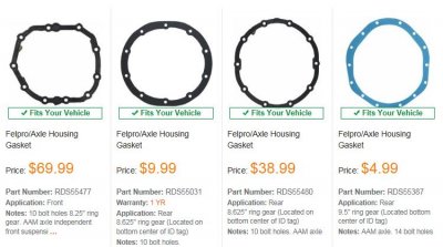

Thanks for the help. Looking for a rear diff gasket right now, and Autozone definitely has me scratching my head.. I've got the 08 Yukon SLT with 4x4 (auto, 4H, 4L, 2)
Does anyone have any input as to which one I need? Haven't found much on the forum (pic attached). Thanks in advance
Not sure if the pic worked, but options are:
10 bolt hole x 8.25" ring gear ($69.99)
10 bolt hole x 8.625" ring gear ($9.99)
10 bolt hole x 8.625" ring gear ($38.99)

Call the local dealer and give them the Vin. Ask if they have it in Stock. They likely won't and then politely ask hey is it the 8.65 10 bolt or thd 8.25.
