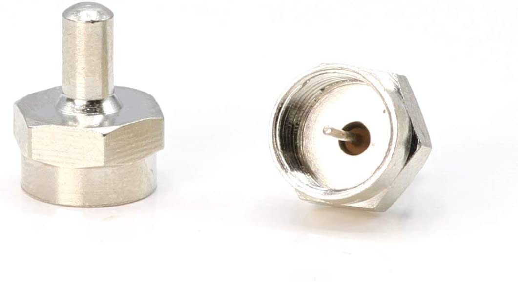

I can tell you from my experience with a 2020 a few things.
Firstly, if you tell Onstar to disconnect you, all they’ll quit doing is sending you the reports. They WILL NOT disconnect your vehicle from their telemetry services and stop recording your data.
Secondly, it’s not as simple as a fuse. It’s integrated into the car network and infotainment and it’s not a single component you can unpower without affecting other systems.
There are some how to vids on older models but I haven’t seen one for vehicles this new. Cutting the antenna coax and intentionally shorting it at the transceiver would likely do it.
