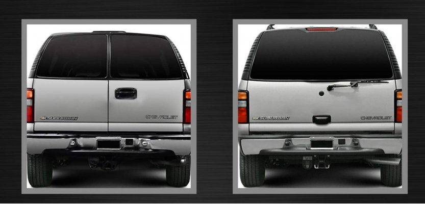

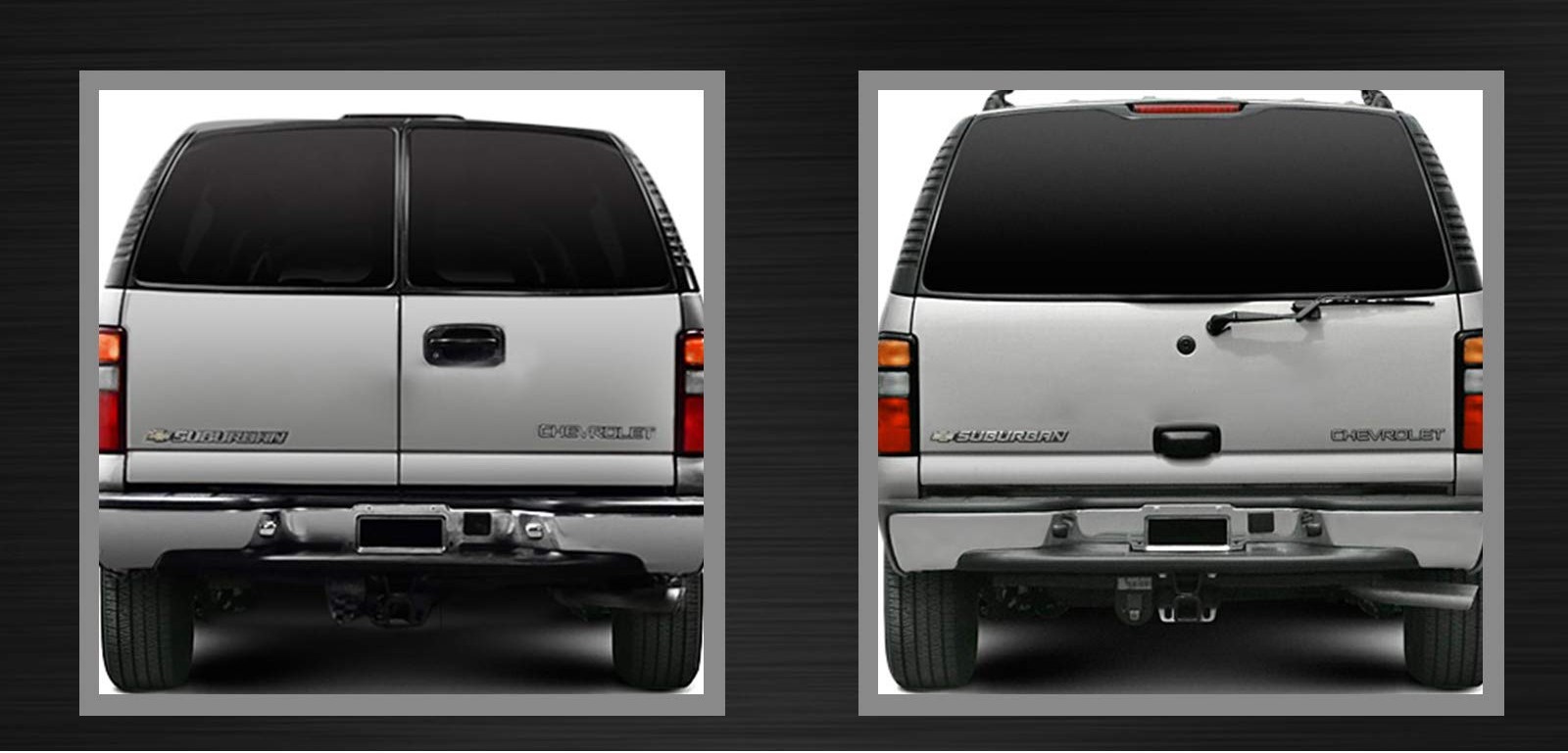

As in barn doors? This has the 5.7L engine in the OBS?
GMT800 SUV's were sold up until 2003 with the barn doors as an option, OR the lift gate. I've heard some people mention that they have seen it on a few 2004 models, but as far as I know it stopped in 2003, and all 04-06 models came with liftgates.
