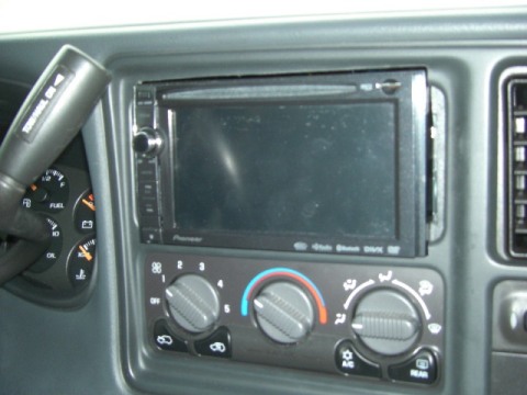

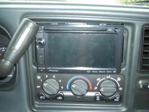

+1. Did it on my 01 Z71 and put a pioneer DD in it. Had to get the new dash like trick said, but my AC controls had a 1" gap where it was from the factory, so it has to be moved up to fit in the 03+ nbs dash.

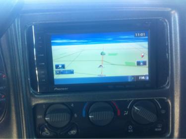

I did it to my hoe about a month ago. I cut some 1/4" mdf to mount to the DD and modified my original dash face and the cage.
That's my finished result, ended up cutting the "bar" under the DD and moved it down about 1/2" and epoxy it back together. Used some adhesion promotor primer and 3 coats of krylon fusion gray and 3 coats of clear.(going to refinish it and make it look "cleaner")
http://www.caraudio.com/forums/general-discussion/361252-double-din-din-half-opening.html
I used that as an idea.
