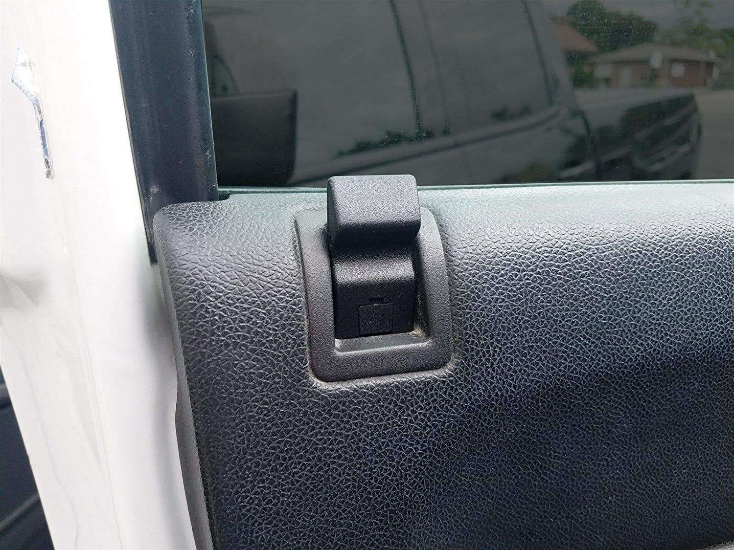

I had the same issue turned out to be the lock door trim was catching on the inside you can pop it off and see if that fixes your issue.

Unfortunately I’m thinking its the actuator. Took that trim piece off, still doesn’t do anything. Only way it will unlock or lock is if i pull it up or push down manually
