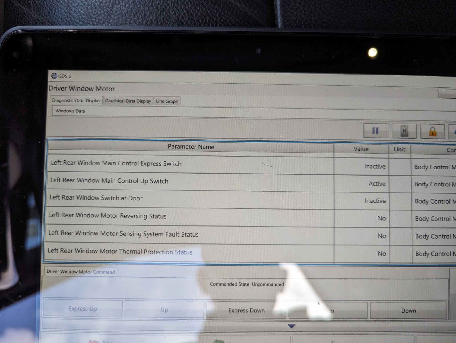

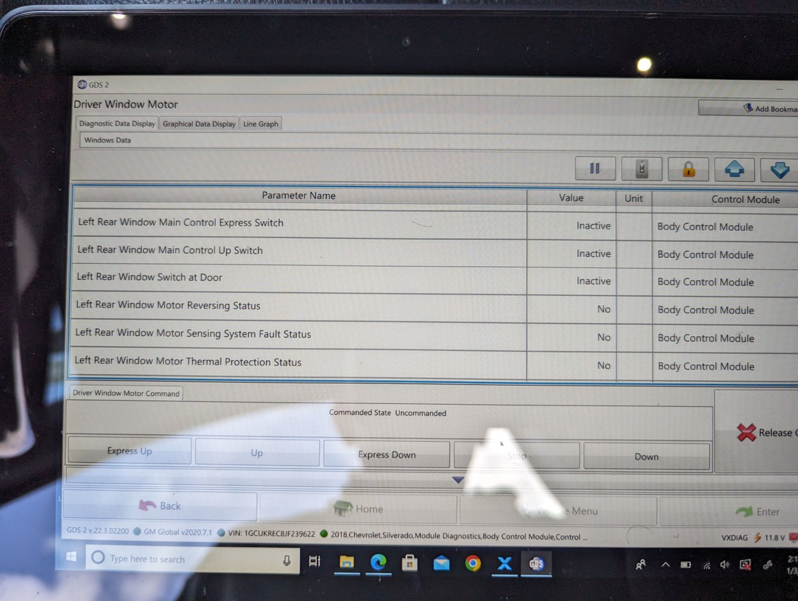

these switches go bad, could have just been a another bad one, but, you might want to grab a scanner that will work with the truck like a vcx nano, it comes with gds2 software which is what the dealer uses, you will need a old laptop or windows tablet for the software. they can be tricky to get working but worth the $100 for something that will save you money down the road

if I get a chance later I will hook my vcx up to the 16 and see if it allows me to see the switch button positions
