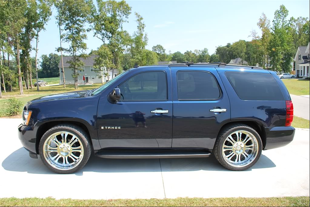

Can anybody tell me by looking at my truck what size drop is on it? I bought the truck already lowered, but not sure how much it is. Also is there a way to tell what brand drop kit is on it?

Looks like a 2-3 drop. Hard to tell what type of kit, unless you can find branding on the springs or spindles.. Truck looks nice..

Thats a nice one. Looks like about a 2/4 drop, here is mine about nine months ago when I had a 2/4 on 24s and they look exactly the same. To me brand does not matter as long as it working right and rides good.

take pics of the front struts
take pics of the front spindles
take pics of the rear springs/shocks
shoot me a email at [email protected] and ill tell you exactly what drop it is.

Well as I went out to take pictures of everything, I saw that the front spindles have McGaughys on them, so I guess that answers my question as to the brand.

got it so prob 2/4 drop kit. If you want a better ride in the rear especailly hit me up ill get you a nice set up.
