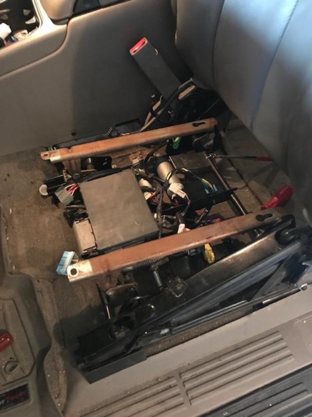

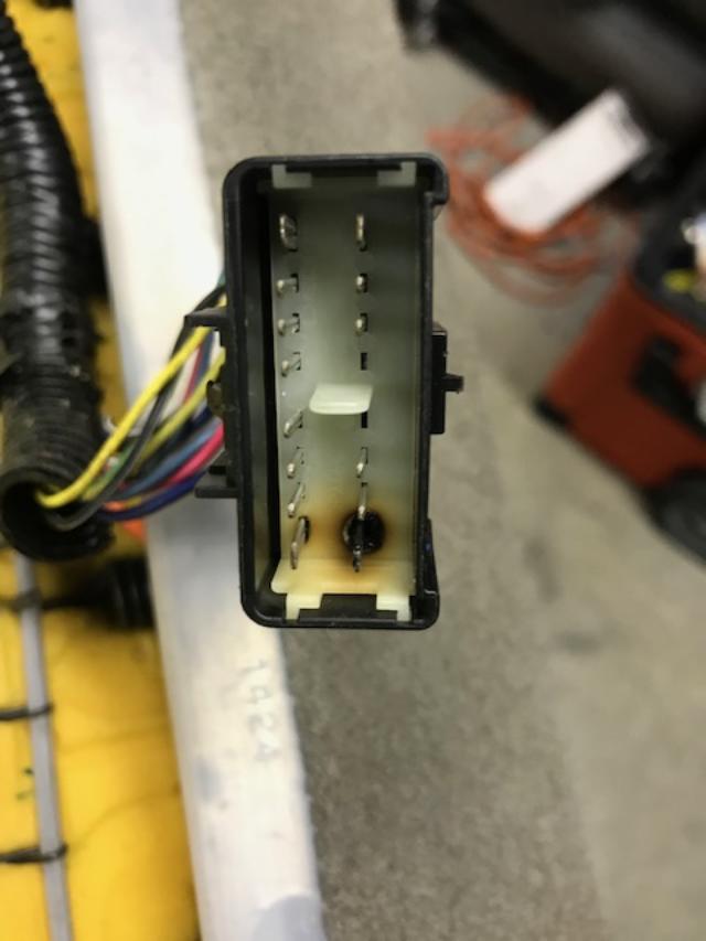

After some reading up on others fixing their non-functional power seats and seat heat I decided to tackle this today.
Removing the DS seat bottom and unplugging the 9 connectors was the toughest part of the fix.

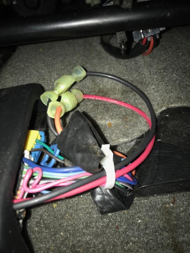

90 minutes later and less that $6 bucks worth of parts the DS side power is fully restored and both seats/seat backs heat up again.
Thanks to those who had documented where to look/how to fix this nagging issue.
