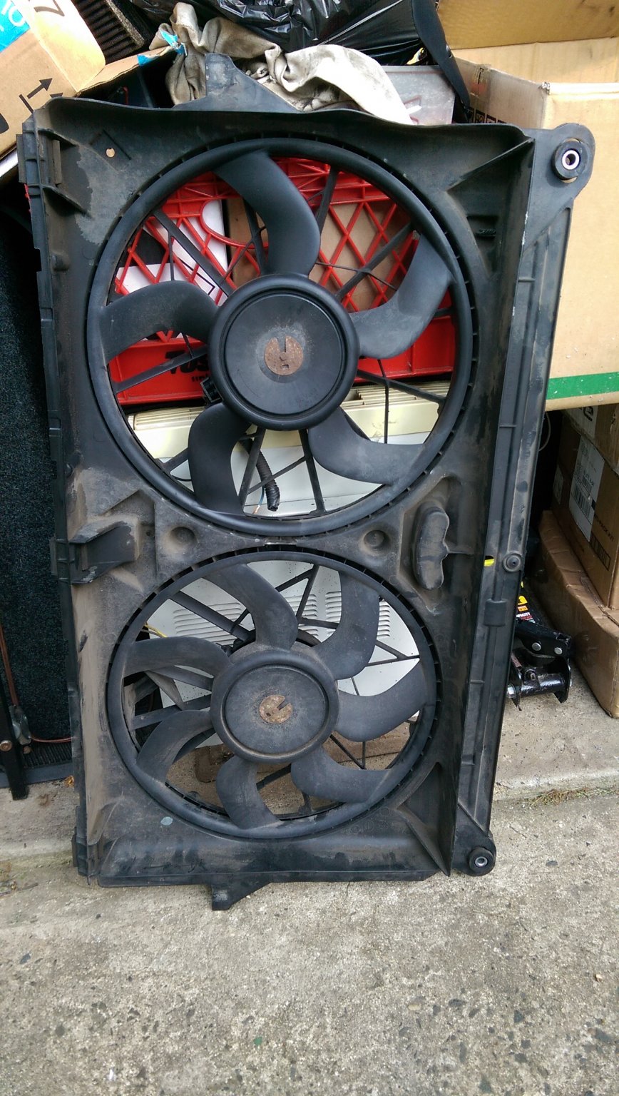

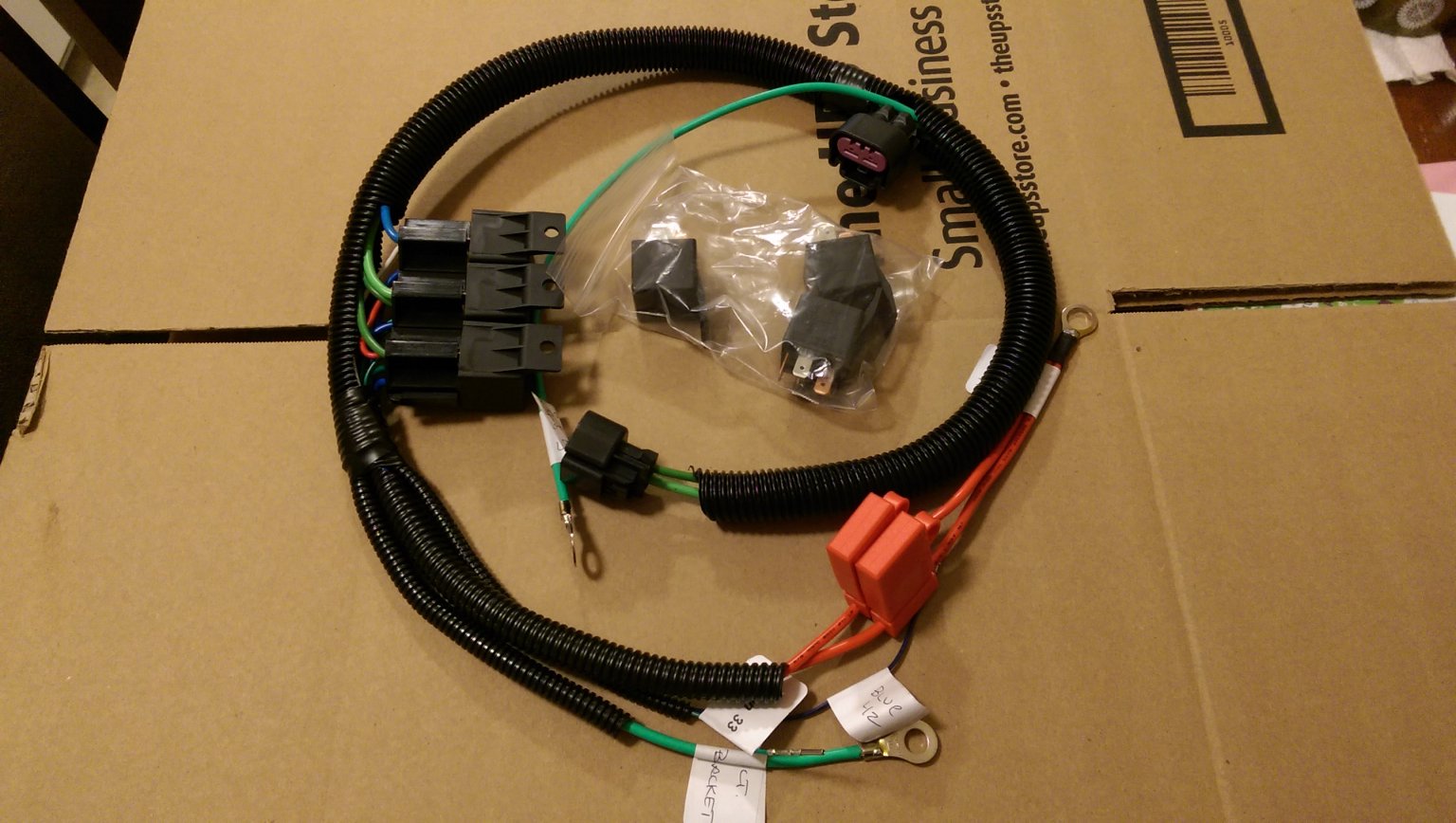

I'm actually going to do this same swap on my 03 Hoe. I also bought the efan harness with relays from ls1fans.com also. I didn't know about the fan size tho. I also got my fans from an 05.IMAG2185.jpg IMAG2156.jpgI also upgraded to a 160 amp alternator.

Will do, and I was hoping to find a harness that didn't have the relays and was strictly PCM controlled. I'll take a look at that thread Red Rocket
26,006
50,869
They all have relays, OE or aftermarket. The fans draw a huge amount of power and the relays are necessary because of this. If you end up getting the OE harness off a wrecked truck, it will have a relay pack. The PCM just has small, low-power trigger wires that activate the relays. No way could 50 amps or more go through the PCM!
