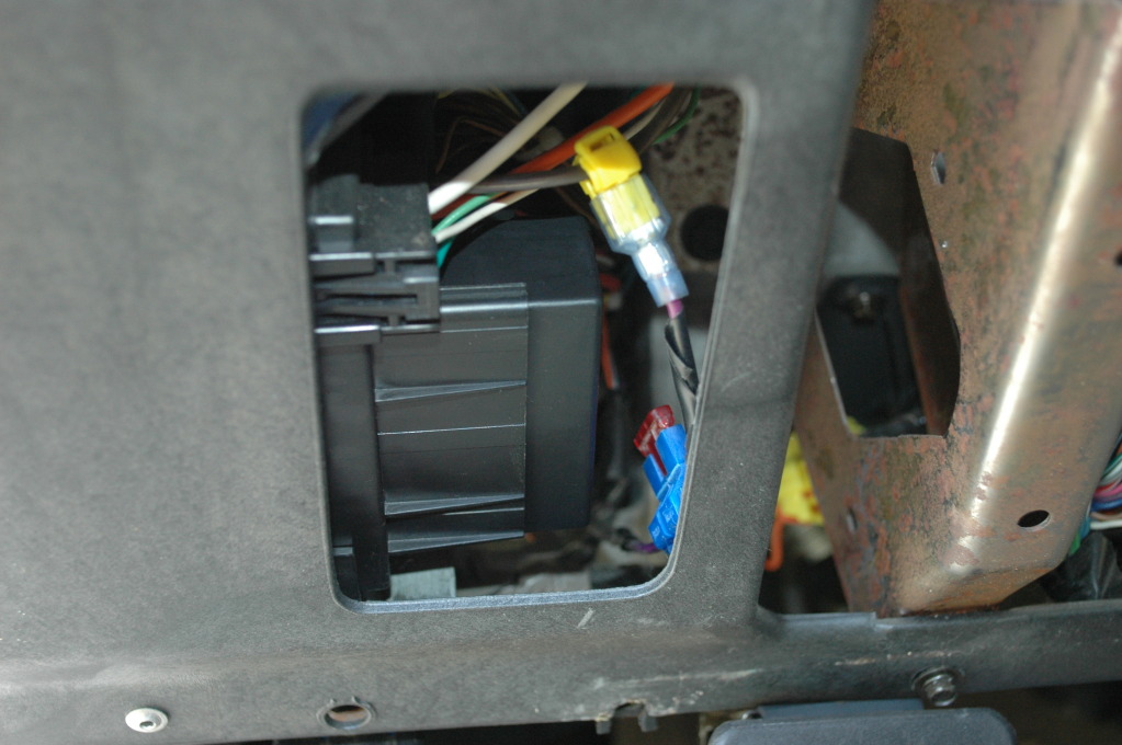

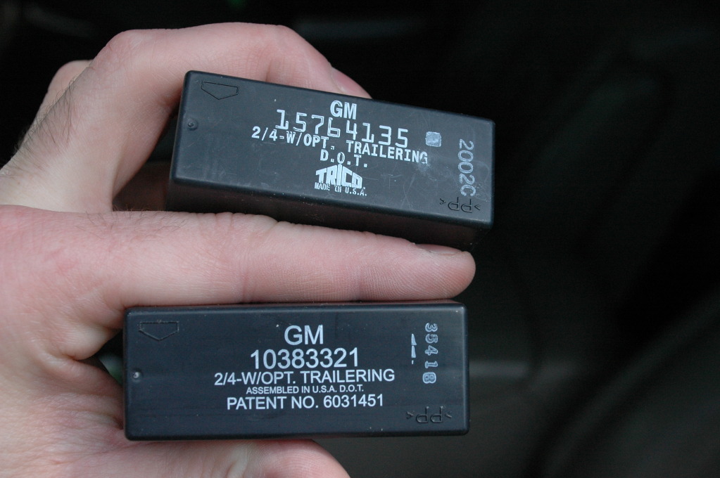

Lucky for you, I just recently had this issue as well and I did all the leg-work for you. ;)
Apparently it's a fairly common problem, actually. You need a new flasher module. They are cheap and fairly easy to replace, you just have to take the dash under the steering wheel off.
Part number 10383321
http://www.amazon.com/ACDelco-10383321-Hazard-Warning-Flasher/dp/B001KSGF14
And there ya' go. :D
That was probably my thread you saw. Nobody ever did respond to it, I just had to figure it out myself. I should note that mine is exactly opposite of yours...my hazards only came on with my LEFT turn signal, and never the right. Don't know if that'll make any difference in the solution or not, but I'd guess it wouldn't.

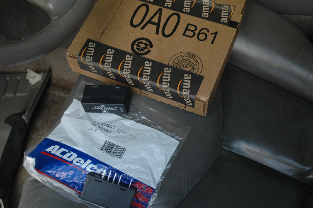

it already arrived, gotta love amazon!

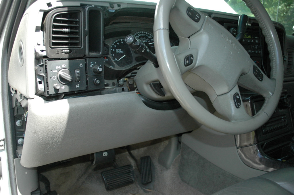

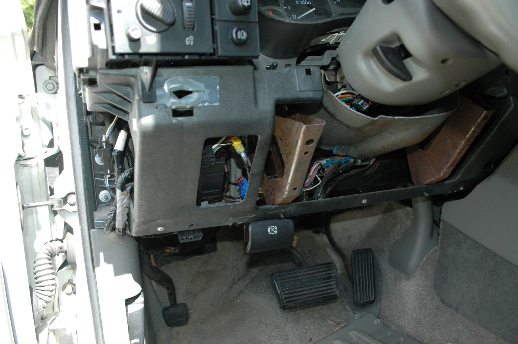

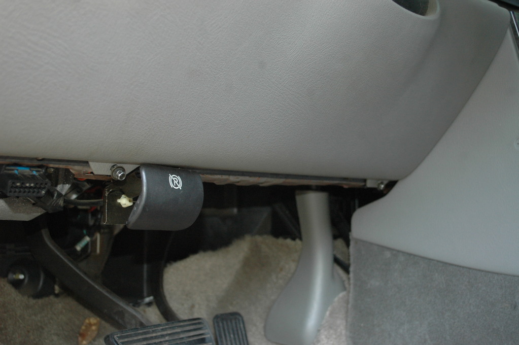

Have you installed it yet? Mine was kind of stuck in there and was pretty difficult to get out. It's just in an awkward spot and hard to get a good grip on....
ATL
ATL
Dec 27, 2011
491
not yet, ive been slacking. i did take a look at the dash today tho. does the unpper piece have to come off to get the bottom piece off? i see the bottom piece has 2 bolts at very bottom
