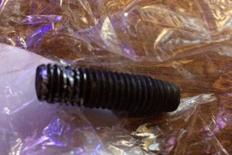

Thanks for all your input, it turned out in fact to be the Manifold Bolt. Luckily, when the manifold was removed, there was just enough of the bolt sticking out for the mechanic to get his extractor-bit around it and back it out. He explained, had it broken flush with the head, I would have been in a world of hurt, mucho-$$$. He replaced the other bolts on the side, gasket, & pipe-flange gasket while he had it off.... As you can see in the photo where his extractor-bit secured to the broken bolt, I was damn lucky to have that much sticking out. He said its common with these because Gm tend to over-tighten these sometimes... (is that ********?)
